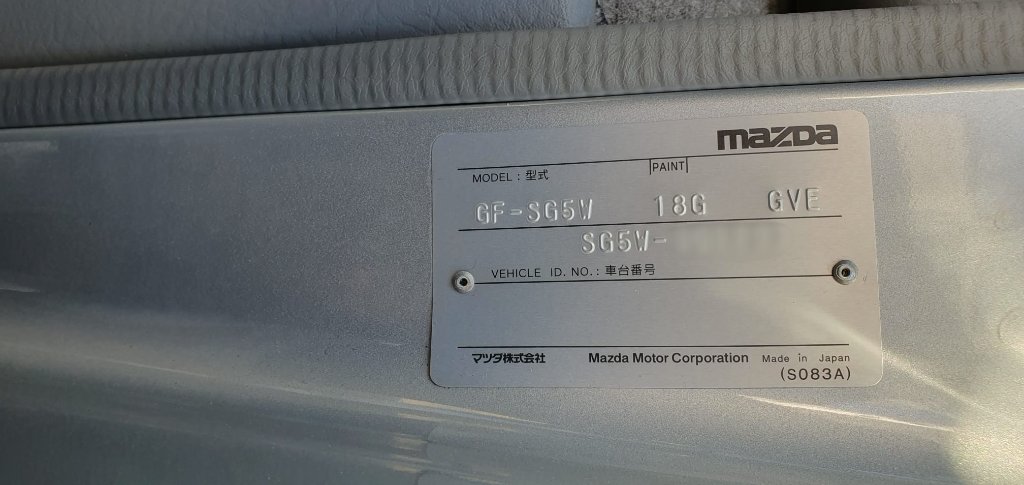

Post by Morgiee » Tue Oct 03, 2023 3:35 pm
Here is the vin plate. Hope it helps identify 👍
Posts: 10916
Re: New member needing some help
Post by g8dhe » Tue Oct 03, 2023 5:30 pm
Your missing the numerical code ? There should be a 6 digit code that specifies the precise vehicle following the SG5W.
I've not seen the leading GF code either.
Check the drivers door side as well as the passenger side, otherwise on the scuttle plate below the drivers position when you lift the bonnet.

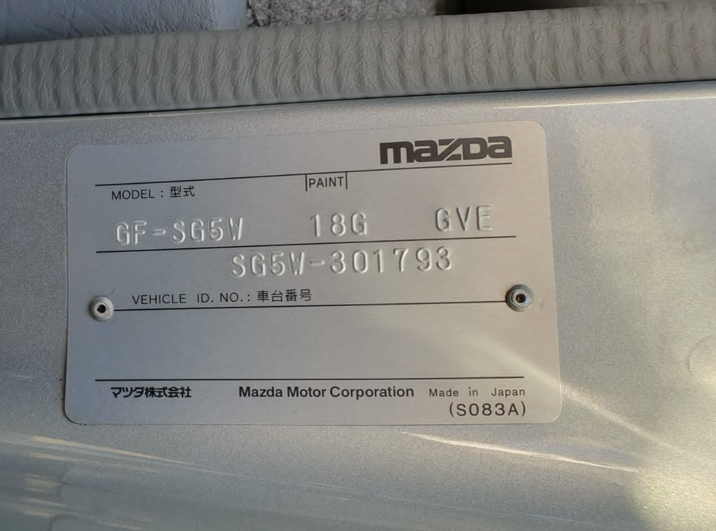

Post by Morgiee » Tue Oct 03, 2023 6:50 pm
This ok?
Posts: 10916
Post by g8dhe » Tue Oct 03, 2023 10:20 pm
There you go then https://www.amayama.com/en/genuine-cata ... sg5w301793
2.5l V6 engine, made 13th May 1999, no sunroof, Tintop.
