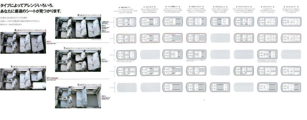

Post by g8dhe » Sun Jul 23, 2023 10:15 pm
These are the various layouts
The one with the nearside rear kitchen unit is the bottom one on the left first column.
The engines are basically the same, although later versions had different turbo arrangements on the diesel and minor variations on the petrol models.
