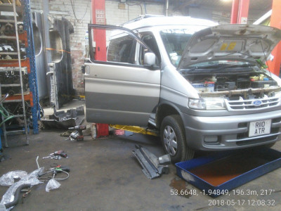

Our vehicles have been doing 8-10Kmiles each year since 2008 and only twice have I had a concern about coolant once, when the radiator failed, a common but not frequent problem where the plastic top of the radiator seals to the metal cooling section, after many years the seal fails and clouds of steam can be easily seen. The other time was when the top engine hose failed with a split on a journey up North, but despite not being able to stop immediately (London elevated dual carriageway at rush hour!!) after temporary repairs I was able to limp Northwards stopping at Bongo Spares (pictures below) for a replacement hose and check of all other hoses (several replaced as a precaution), before continuing up to a Scottish bash!
