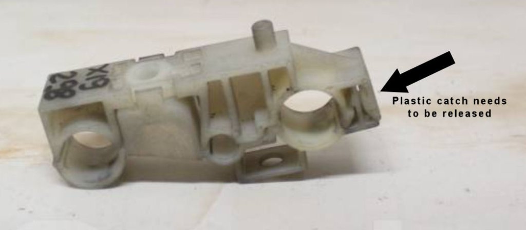

on the rear air con lines I see a leak at the 90 degree bend there is a plastic clip that holds 3 lines I undid the nut bolt. but how does the clip come apart so I can remove one of the lines to repair the pinhole the clips I'm just unsure
Posts: 10916
Re: Green Fluid Leak - Please help
Post by g8dhe » Fri Apr 07, 2023 9:26 pm
The pipe clips have a catch at one end that you need to release to allow it to pivot up and free the pipes;
Post by jboocock » Fri Apr 07, 2023 10:58 pm
fantastic with the schematic , cheers
