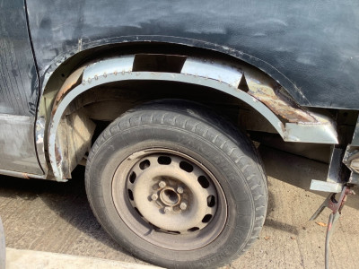

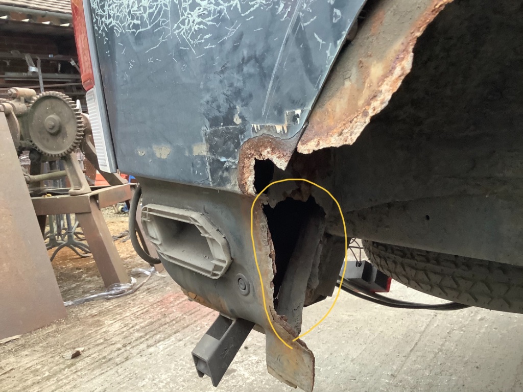

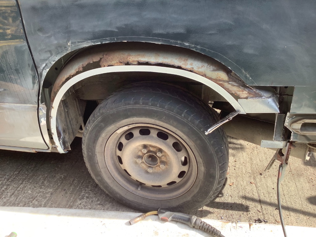

Hello , I’m taking on my partners repair work , does anyone have a pic of what the rear substructure look like as marked in my picture , many thanks
TheLongRoad
Posts: 480
Re: Rust
Post by TheLongRoad » Thu Sep 22, 2022 8:11 am
As it’s behind the bumper and under arch does it need to be exact? The bit with the plastic bumper support is usually suspect as well. How’s the rear cross member?

There really isn't any major part missing, merely the attachment points;

Re: Rust
Post by Nozzer » Thu Sep 22, 2022 1:06 pm
Thanks both , just trying figure out if the void was part of the original construction .

Post by TheLongRoad » Thu Sep 22, 2022 1:11 pm
More than likely one of many voids that are now opening up after all these years. Which rear arch replacements have you gone for, sprinter or the custom ones from Bongo Spares?

Bongo spares , expensive but your paying for the development , they look to fit very well

I think they look better, the Sprinter ones don’t seem to have the correct curve and as you say they are a lot less faffing about. I see they have their own front cross member in thicker gauge steel. Good to see these old vehicles ‘saved’ for a few more years.

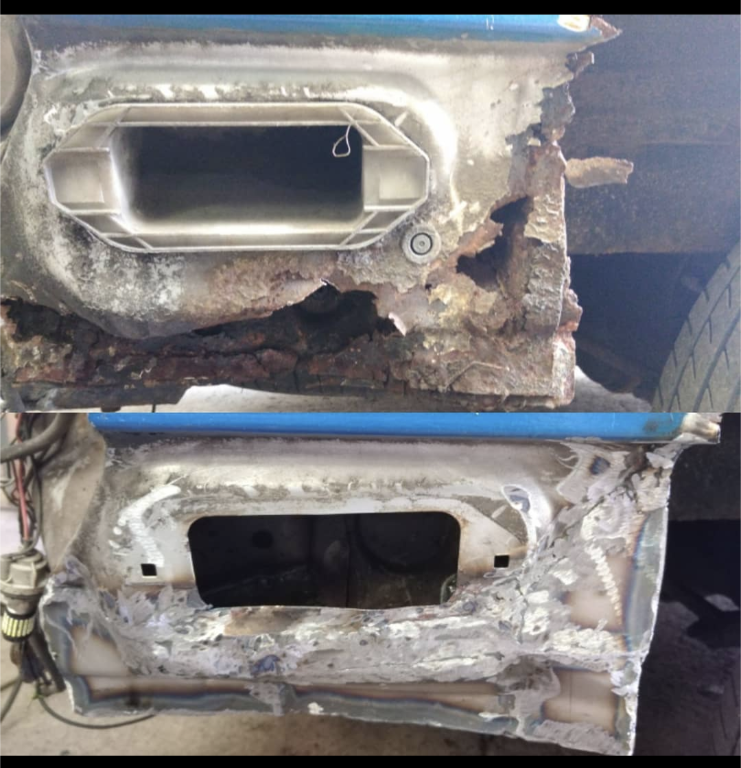

This is from my van

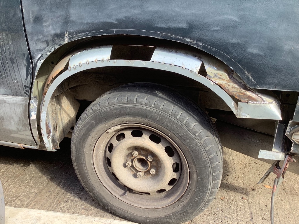

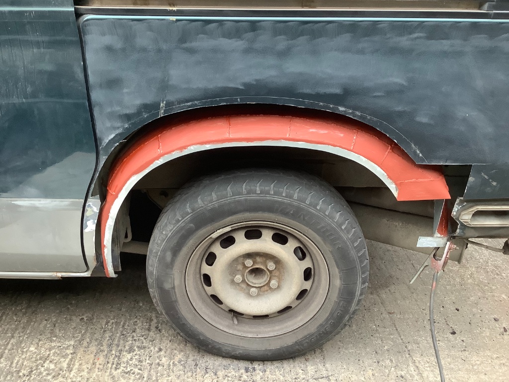

Post by Nozzer » Sat Sep 24, 2022 7:39 pm
Thanks all , good first full day on it
TheLongRoad
Posts: 480
Re: Rust
Post by TheLongRoad » Sat Sep 24, 2022 8:49 pm
Nice job. Well done. Will you be doing the spray painting as well?
