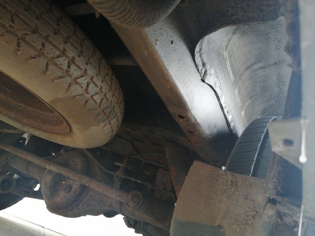

Doesn't give me a lot of info but he's sent me a photo of the under side. Definitely going to have to go and check it out in person.

Well it tells you one thing no one has ever checked the spare tyre its the original 20+ year old one that is good for 50 miles when new! There 1/2 width or something like that!
