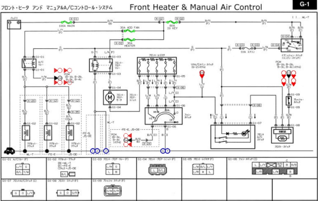

Here are the diagrams and locations for the parts;

Many thanks Geoff, that's spot-on.
It looks like the relay is by the heater controls in the middle of the van.
