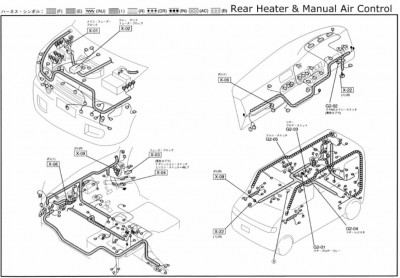

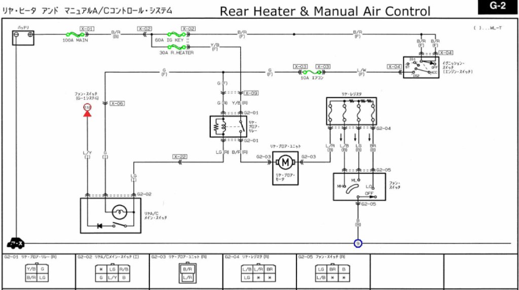

Post by g8dhe » Mon Jul 11, 2022 10:09 am
Here are the diagrams and locations for the parts;

Post by Lemner » Mon Jul 11, 2022 10:38 am
Many thanks Geoff, that's spot-on.
It looks like the relay is by the heater controls in the middle of the van.

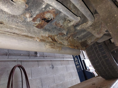

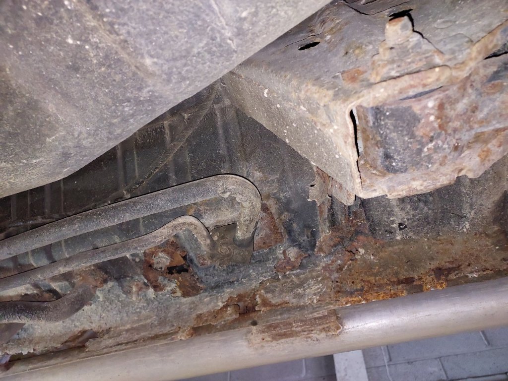

Recently bought our Bongo and we are van virgins. Unsurprisingly, perhaps, we have found a severe corrosion problem underneath which will require lots of work - and money! Our local van restoration garage has asked me if I can tell him what the two pipes underneath the rear heater are for (gas/water, etc), because he will need to remove them to rip out the corroded material that they sit in, before replacing all the sills etc.
Do you know what the pipes contain?
The garage have asked me if I want to remove the rear heater myself before handing the van over for repair work, but I am dreading taking the pipes off if, I'm honest, as I think they will just snap. [-o<
Are there diagrams that show both of these pipes?
Cheers!

Post by g8dhe » Sun Jan 22, 2023 2:54 pm
There should be a total of 4 pipes!
Two of them are the engine coolant which is used to heat the heating matrix to generate warm/hot air from the rear air-con.
The other two are the refrigerant pipes from the air-con compressor and cool the air circulating thru the air-con in the rear.
Its quite common for the two heating pipes to have been disconnected as they tend to have rust problems and people frequently by-pass the feed to the matrix.
