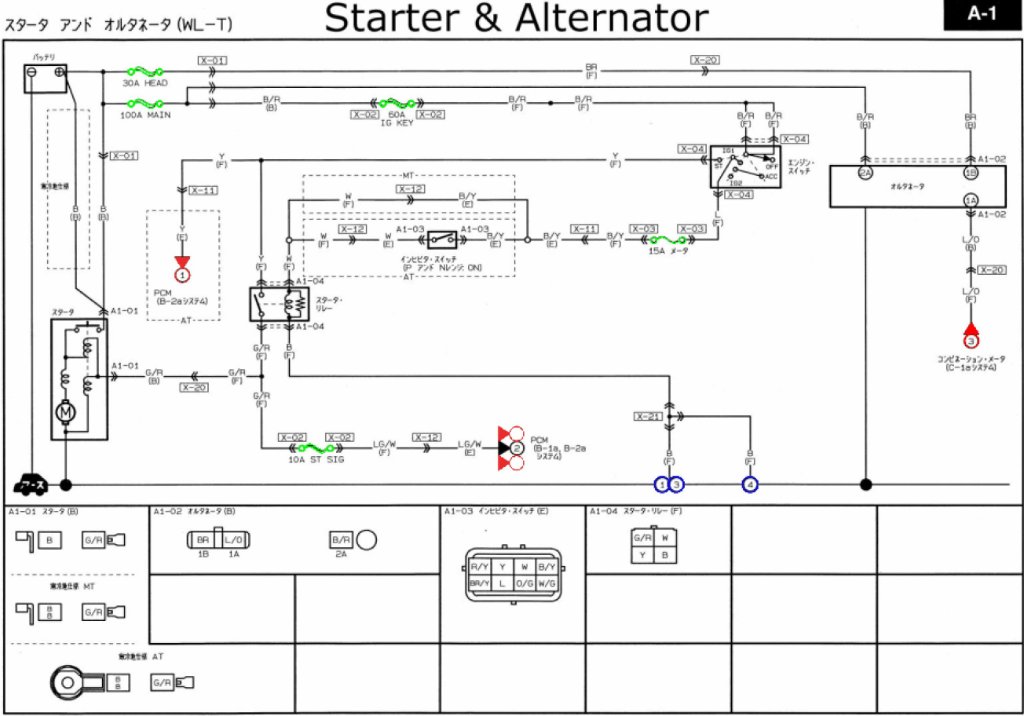

I have tested the 10A fuse shown here and it is also okay:
Any other suggestions of what I could check? Problem almost certainly stems from no activation power getting to glow plug relay.

That tends to point back towards the ECU :-( Have you had any work, especially welding carried out at all lately ?
