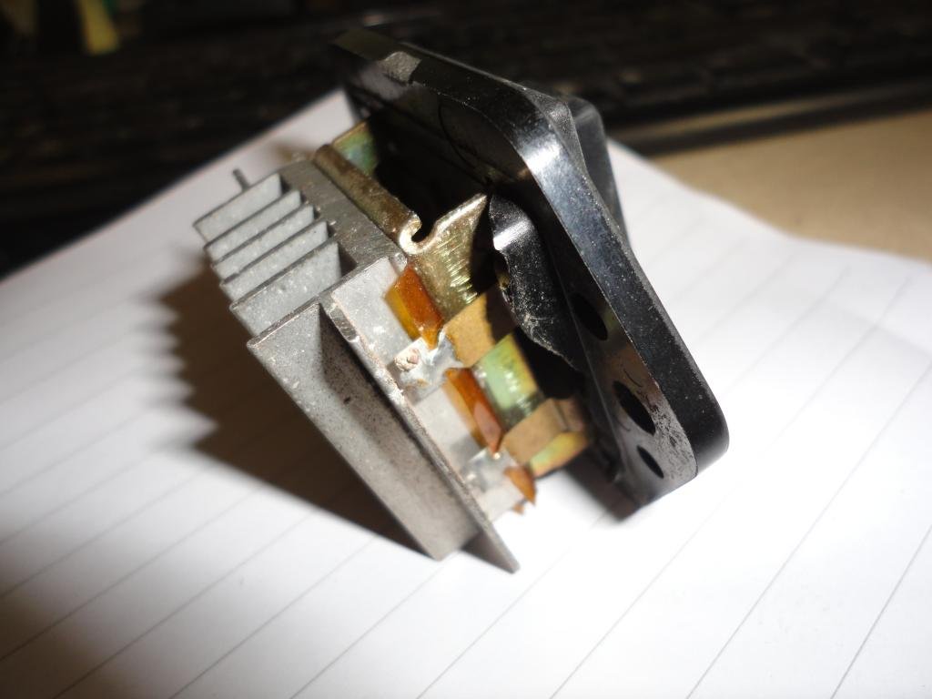

The resistor pack (with its thermal fuses which are often the problem here) is located where the probes are below;
The resistor pack is here and the tabs are soldered down, when they get hot the solder melts and the tab flips up, minimal solder is needed and I suggest if they have popped use as much of the original you can as I don't know if its a low melting point solder or not!

I've had a look at the resistor pack and all looks OK. The solder has not melted.

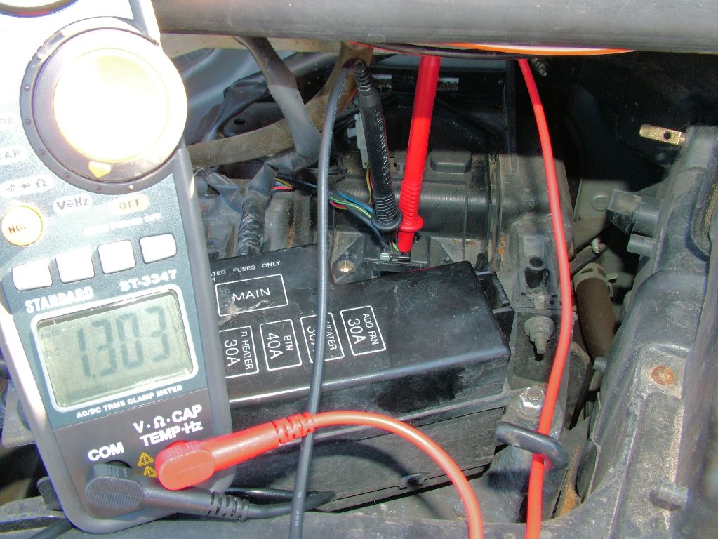

Unplug the motor (2-pole connector on lead from fan unit) and apply power, that will confirm if its the fan that is faulty or not.
After that check the fuses and the relay;

Thanks again for your reply. The fuse at the under bonnet fuse box and that is OK. Power isn't getting to the connector nearest to the fan.

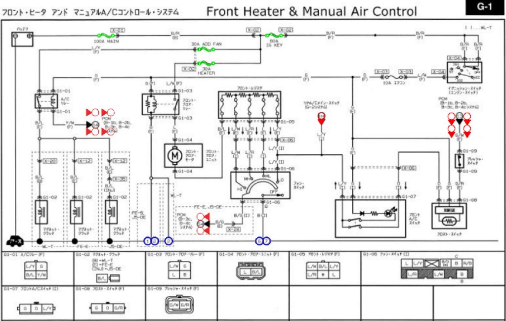

Taking a look at the wiring diagram has highlighted the issue.
Fuse 5 is marked as air con but also has a common connection with the front heater fan relay.
I had assumed that it only did the air con (which hasn't worked in years) so cut the wire at the back of the fuse box and re-purposed the fuse for the switched 12v to the EWP.
I had also misremembered that the wire from fuse 5 had been cut by a previous owner which didn't help. Should have taken another look- it was the wire from fuse 20.
