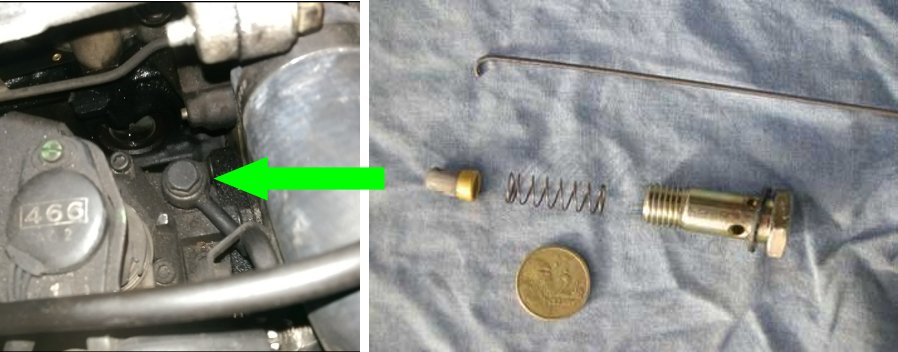

Have you checked the little banjo filter ? It should be the last filter in the system and is a small metal gauze item as shown below;
They are sometimes removed, but carefully extract and wash it out with petrol is a good option.
