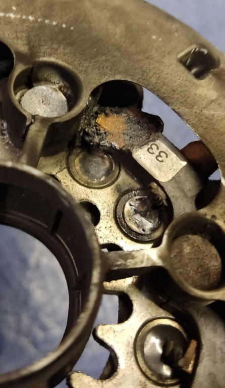

Couldn't get hold of the electrical bloke, so took it apart for a look.
Removed the rear cover, desoldered the windings and removed the regulator/diodes.
One of the diodes was visibly melted and bits of melted plastic were dropping out during the dismantling process.
From hunting online it seems like I can get a replacement diode pack but only in 80A or 70A, not in the 90A. It looks like the refurbished ones mostly used these too as they are mostly rated at 80A.

If you search the posts on here around 2010 time you will find quite a few failures of alternators after around 12 months when lower rated diode packs were used.
