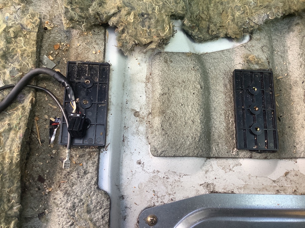

I’m just stripping the carpet to board the back and happened across what’s in the picture....I wonder if anyone could shed some light on what these mounts and cable might be for?

Welcome aboard!
Doesn't look like a standard item for a Bongo Friendee, most likely some add-on device that's been installed at some time.
Best to follow back and see where / what it connects to and that might give you a clue!

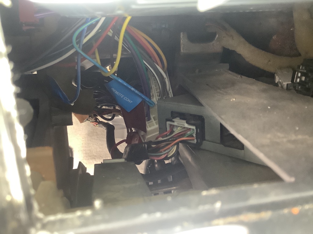

Thanks Geoff...the smaller cable is just connected to the chassis, so just an earth I guess.The other goes into a silver box behind the dash and then terminates again after about a meter of cable. I guess it was some sort of AV add on.

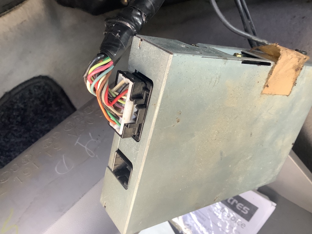

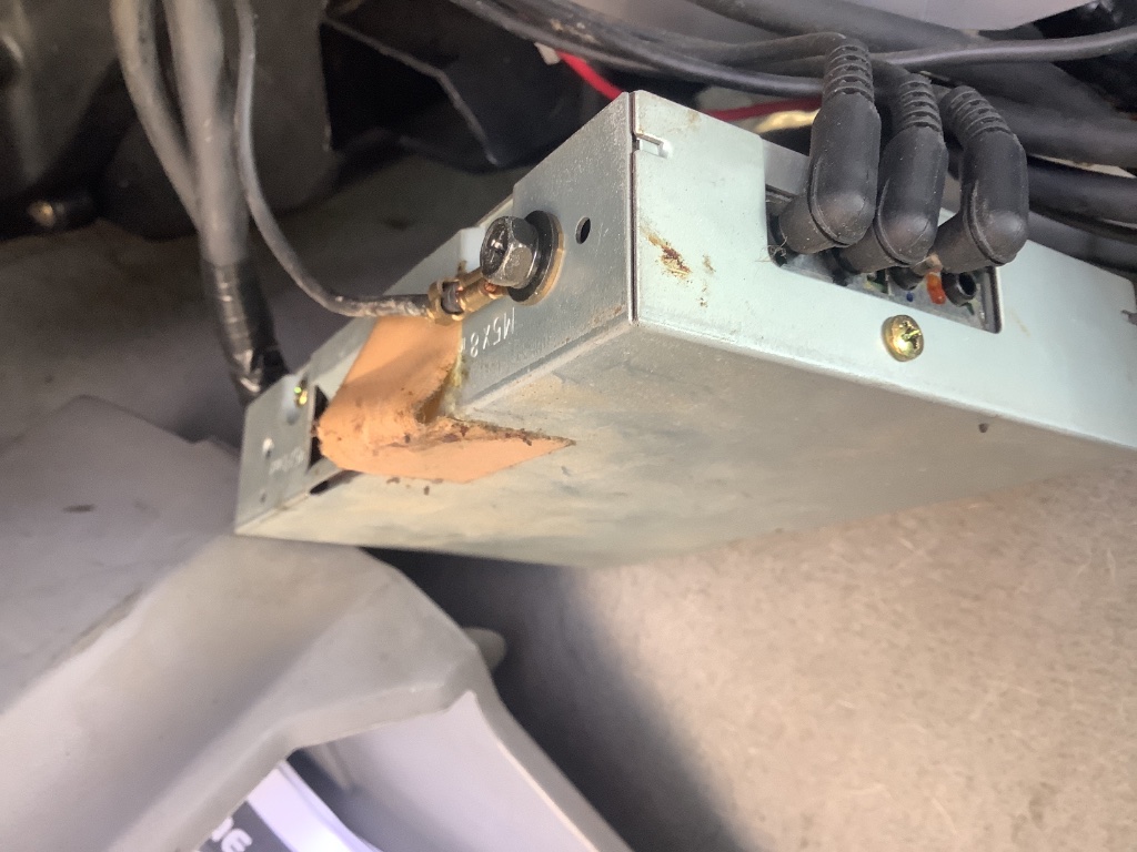

I’ve got the mysterious box out. Nothing on it to say what it is. The Jack plugs disappear up the passenger side by the windscreen off to the back somewhere. Who knows!! :lol:

If there are several aerial cables going to it then its most likely an aerial diversity switching box, it will switch in the best combination of aerials to get the signal mainly for TV as a lot of Japan is mountains and signals come from a variety of directions. See https://www.google.co.uk/search?q=aeria ... +switching
