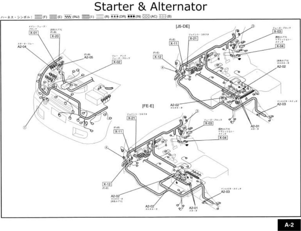

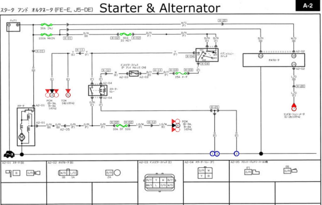

Can you hear the relay A2-04 click as you turn the Ignition key to Start, see diagram below.
The Coolant alarm should turn OFF when you turn the Ignition key to Start on the Haydn alarm as its power should come from the IG2 circuit.

Well if the relay is all working but the starter isn't making any noises at all, you can check that 12 volts is reaching it via the relay, this power operates the solenoid and contactors within the starter, the contactors then connect the main power to the starter windings. A common problem is the contactors have burnt/worn out and need replacing, provided your not a COLD START system for Northern Japan then these are replaceable otherwise they are not as they are sealed within the starter motors itself. New contactors are available on eBay various types of kits https://www.ebay.co.uk/sch/i.html?_from ... s&_sacat=0
