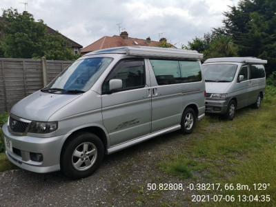

g8dhe wrote: Mon Jul 04, 2022 8:05 am The spring loaded flaps are used to close the tent inwards when you lower the roof to make sure the material folds inwards. If the material isn't taught when fully raised and the beeps have stopped even with the Ignition ON then are you sure some one hasn't put the wrong size tent on, later versions, Aero onwards, the roof went higher and the tent was taller, but its several inches difference. If the beeping doesn't stop then you haven't reached the top position, its not clear from the text if beeping has stopped or not ?
Do you have a picture of the tent from outside when the roof has stopped going up and does the beeping stop at that position ?
are you sure some one hasn't put the wrong size tent on?
Truthfully, no I am not sure, but see below photos for yourself and let me know if you know different
Beeping does not stop when 1. Engine is running and 2. roof is up fully (or as much as it can possibly go) and only stops when 3. Engine is off
See below pictures which show 1. the AFT fully erect 2. beeping noise on (obv you can not hear that haha) and 3. the inside of the pop top which show the spring loaded flaps hanging loosely / not springing outwards which is what I think is the problem
I would like to know if it's a case of taking this out / apart and replacing the spring or do I need to replace that part fully, if at all? If it has nothing to do with that, is it something else?
Also something to note: Roof is going up and down absolutely no problems with just the noise at the top. It does stop in the middle, but I dont have to press the little "STOP/CANCEL" button to let the mechanism know that the rooftop is clear, I just push 'CLOSE' roof and it continues on closing.
Also to clarify: its not clear to me yet whether the tent not being taught and the beeping noise are the same problem or mutually exclusive i.e two separate problems.

Yes that is definitely a case of a newer model tent having been put on an older roof :-) Been there done that myself! Ended up being able to exchange it with someone who had the reverse combination so we both ended up with the right sizes!
That doesn't however explain the beeping continuing, but I suspect that who ever worked on it before may have played with all the parts involved and hence the limit switch is one way or another not tripping or telling the computer its reached full height!
