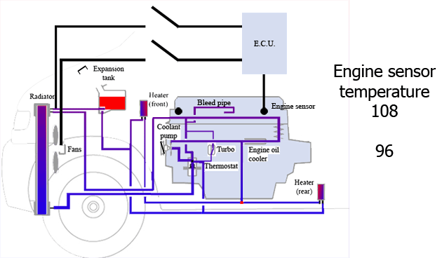

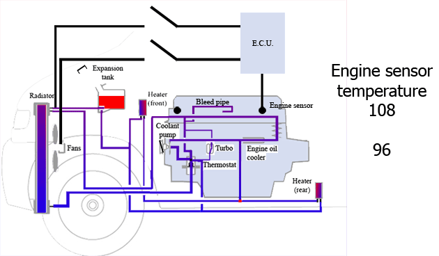

What do you expect the radiator temperature to tell you precisely ?
There is coolant flow thru other parts of the cooling circuit as well as the radiator which only comes in to play when the thermostat opens to allow cool coolant to add to the flow.

The ATF is cooled in a separate section of the radiator at the bottom, it has its own connections etc at the bottom.

The cooler is built into the rad, there is a wee difference re thermostats , the wltd is fitted on the return side of the flow which means it is getting hit with cooled coolant and will tend to open and close more often than the normal stat position. It will be like a fiddlers elbow .
