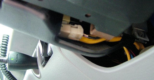

The buzzer not working suggests a connector may be unplugged under the steering wheel, does the key light come on when the door is open?

Oh sorry - I see you've specified under the steering wheel, not the one I was thinking of. I'll check the light in the morning and mention that to them if it's not on. Thanks very much.

This one is sometimes disconnected if you like to leave the drivers door open;
as it stops the beeper when disconnected/pulled apart!
