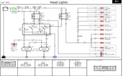

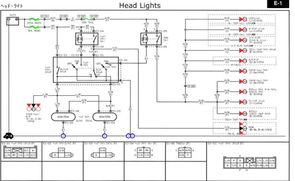

Yes there is a relay E1-05 on the diagram below, which is situated on the nearside front wheel arch;
Not all of the relays may be present depends on options at manurfacture
