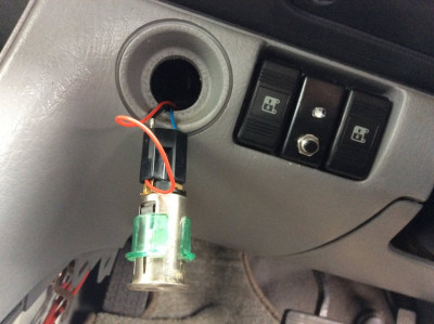

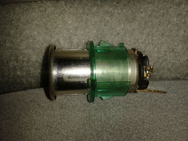

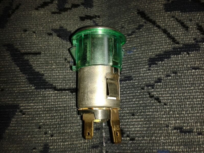

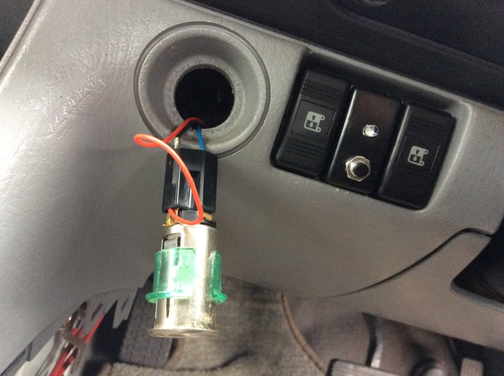

Yes its meant to be removed from the front, but its fiddly getting your fingers around the plastic sliding bit to release it!
Locked position;
Unlocked sliding off;
Hanging out, but plastic clip broke in process! Normally slides back down the body and off once wires are released;

Geoff, what's that dodgy looking red wire doing there? It looks like an after thought.
Posts: 10641
Re: Cigarette socket removal
Post by g8dhe » Wed Jan 05, 2022 10:41 am
Not sure looks like a simple tap onto the Ancillaries supply! The images aren't from my own van actually merely the ones I located when trying to get mine out!

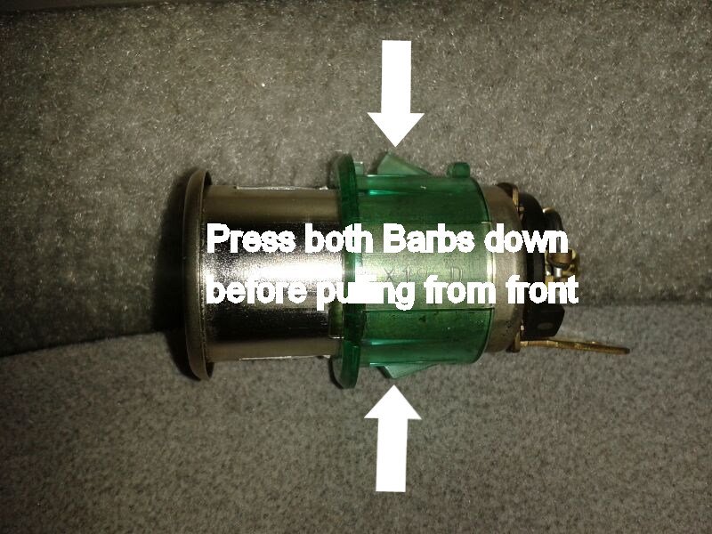

Yes the green plastic bit that surrounds the body, it has two press clips that release the plastic tube to allow you to rotate it and then slide it off the the body, then the main body pulls out from the front of the hole.

I've only done mine once and, it was several years ago now! It is certainly fiddly. I used my camera phone to inspect and video it first then planned what I needed to press and then twist/turn the green tube to release the entire unit.
You have clocked the need to press in both buttons ?

When I say rotate its the green bit that seems to need to rotate as I recall around the body of the socket, I think then the metal has holes to allow the buttons to be depressed down into hence releasing the body itself.
