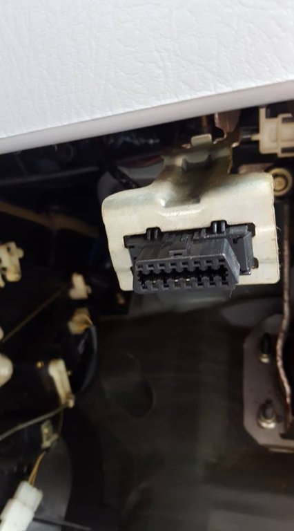

I have been given a cable which plugs into the OBD socket in the Bongo. The other end, I believe plugs into a Laptop and then you need to log into a website to get the results. Trouble is I don't know what site, by the way the cable was free, so if I can do this, that's great but if not, nothing lost :D

Post a picture of the cable but generally for an OBD2 cable, they just plug into a laptop and you have a piece of software that then reads codes. Unfortunately as far as I know all the bongos (I might be wrong for the very late ones) weren't OBD2 compliant, so you can't use such cables.
They instead had a proprietary diagnostics port. All the details for this are already on the forum. What it effectively gives is that when you have an error light in the dash you can bridge pins in the socket which cause the light too flash which gives you the code.
My guess is that you won't be able to use the given cable but as I say post a picture and members might be able to let you know what you have and you might be able to use it with other vehicles.

Thanks for the reply Sotal, I did a bit of a search myself, I think some of the software may have been available in the US taking advantage I think of the Mazda/Ford link but I don't see it available here, one was Toad and the other Forscan (unfortunate name). The cable does connect in at the vehicle side although it looks unlikely until you try, other side I am not so sure I would know where to put in, not this Laptop anyway. hoping now to post some pics, hope that works and if anyone has any ideas, that will be helpful, thanks in advance.

Post by Winniebongo » Sun Dec 12, 2021 8:40 pm
I don't think the other 2 have worked so will try again here;

The connecter cable merely changes the plug/socket style, unless it has a built in module (computer) the ECU in a Bongo does NOT output the OBDII protocol so the straight conversion plug will do nothing to help. There are suitable readers but your normally talking commercial types costing several hundred to thousands of pounds.
See here for more info https://www.igmaynard.co.uk/bongo/forum ... 76#p709676

As said above, that is just a dumb adapter cable.
Forscan cables are just standard elm327 cables with a switch to flip a couple of the pins over. They plug into USB and then into the OBD2 sockets (the other end of your cable).

Forscan is designed for ford vehicles. It works fine in this country and gives much greater detail than plain OBD2 but only on compatible Ford vehicles. It won't work on the bongo.
I don't think the adapter cable will be of any use to you, the car simply doesn't have the computer to communicate with anything else.
I heard a rumour that very late models had OBD2 functionality but never actually heard of anyone having it.
I've used the built in diagnostics multiple times now and had no problems. It led me to an ABS sensor which needed replacing.
Use the site you mentioned as a starting point but video the light flashing on the dash and I'm sure someone on here will help you to figure out what they mean.

Yes OBDII was introduced after 2002 sometime there is a proper OBDII socket under the dashboard to the left of the steering wheel
I'm not clear if the original socket is also in position I suspect it is, possibly the cable might work on those versions but I would suggest using the OBDII socket is a better choice!
