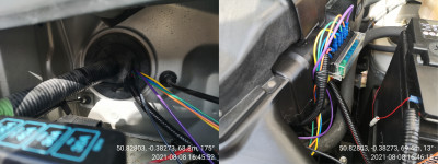

I use both grommets, the one in front of the driver I just make an extra hole close to the centre hole that is in use, or un-tape the corrugated tube used for the existing wires but that is usually more difficult! Likewise on the passenger side, you need to drop the glove box out and then shine a light up into the corner and you will see the grommet - I normally just push a screwdriver thru, then tape the wires onto the screwdriver from the bonnet side and pull them back thru.
See here for the drivers side one;
The above photo's were taken part way thru, all the wires end up inside my own corrugated tube for protection by the end of the process.
