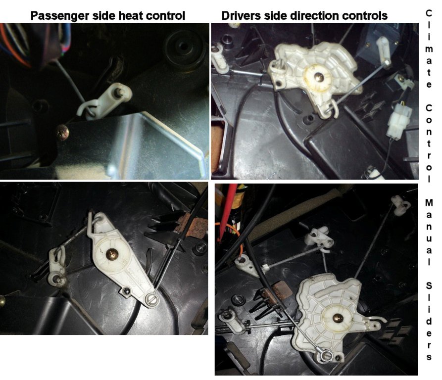

I suspect your talking about the SERVO and its motor inside the case rather than the Fan motor under the bonnet ? There are two servos (like model aircraft servos) these drive via a link wire the actual flaps one servo on each side as below;

g8dhe; Yes I have heard them called servos, so that's the same thing. I have only looked at the passenger's side, should I maybe be looking at drivers as well?

The servos only rotate a to and fro over an angle not sure what the angle is and then the wire link moves the heating flap, or rotates the disk which in turn varies the positions of the various directional flaps.

It's a bout 90 degrees on the passengers side one but with a big chunk missing in the middle, not sure what that makes it but 90 degrees and to end anyway. I will have a look tomorrow but if this one i am dealing with is the heat flap then I can't see how the other could take up the slack in the middle, I don't know everything though, so we shall see :)

No the drivers side control operates the directional flaps, the passenger side controls the amount of hot air added to the stream. The controller however only allows the maximum heat out when it is set for the lower regions and possibly the windscreen, but reduces the heat when only the face directed vents are selected.
