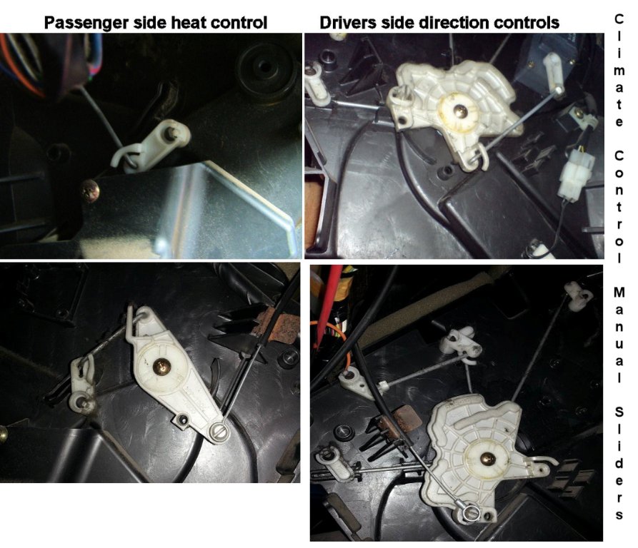

I suspect your talking about the SERVO and its motor inside the case rather than the Fan motor under the bonnet ? There are two servos (like model aircraft servos) these drive via a link wire the actual flaps one servo on each side as below;

No the drivers side control operates the directional flaps, the passenger side controls the amount of hot air added to the stream. The controller however only allows the maximum heat out when it is set for the lower regions and possibly the windscreen, but reduces the heat when only the face directed vents are selected.
