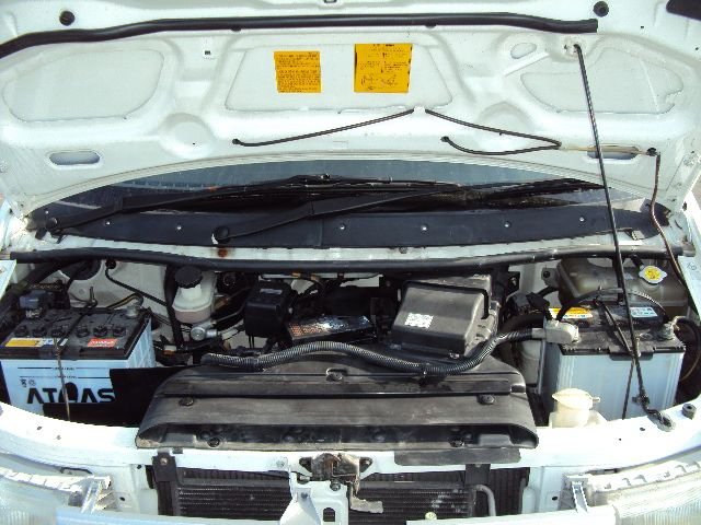

Due to various reasons my Bongo wasn't used for a long period and subsequently the battery was flat. The battery would not charge and was replaced but since fitting the battery not charging light has appeared on the dashboard indicating an alternator fault, however although the battery was recommended by the car spares website for my registration number it is only a 70a battery not 90a as recommended as a minimum on your site. Could this be causing the problem or am i still looking at an alternator issue. Also I have 2 batteries fitted how do i know if one is a leisure battery?

No the original specifications only called for a smaller battery, but in the UK we tend to put a slightly larger one so normally a 90 AH rating is fine.
Given the above the Japanese also fitted a second starter battery for the Cold Start option required in Northern Japan (-40℃) so first make sure that the second battery is a Leisure Battery (LB) and not a dual SB! If it has a large +ve terminal connector with the cable running in a convoluted tube across the top of the air con air intake then its a dual cold start battery - BE AWARE - the +ve terminal will be LIVE to both batteries under ALL conditions so if its disconnected it needs to be well insulated so that under no circumstances can it short to the chassis!!!!

Just as Geoff says…
If you have the 'Cold Start' dual batteries you will have a switch with an engine logo down by your right knee somewhere to activate the system.

Thanks for the replies guys, the picture has helped i know now that the second is a leisure battery. i think i need to test the system to see if the charging light problem is an alternator problem. i would like to be sure as i can before laying out the expense of a replacement alternator. this problem has only occured since fitting the 70ah battery. Thanks for the warm welcome to the forum. :D
