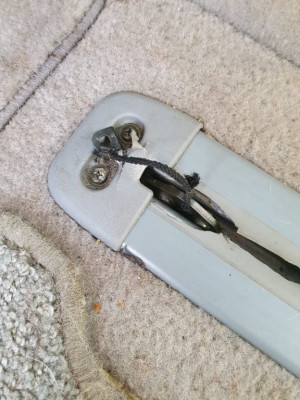

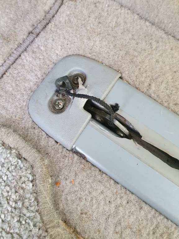

Hello all - well nothing seems to have worked, still 10-20cms short of being at the very front of the track. Feels as though something is stopping it on the passenger side. Does anyone know what this is or if it is likely to have anything to do with it?

Post by g8dhe » Fri Oct 29, 2021 3:10 pm
Is that not the seat stop device viewtopic.php?f=3&t=21851 not sure if the images are still there or not ?
Posts: 7724
Re: Folding seat query - novice Bongo owner!
Post by Northern Bongolow » Fri Oct 29, 2021 9:50 pm
Looks like it Geoff but it's usually at the rear of the slider to stop the rear seat hitting the rear window. Maybe someone moved it, try hook / lifting it out, it lays in the bottom of the runner
