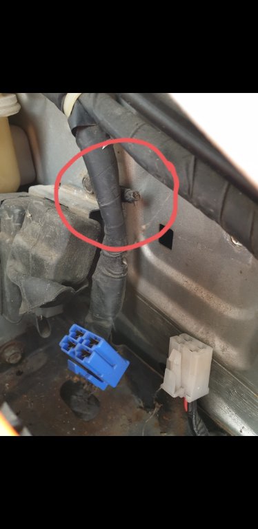

The lb does charge but when the fridge was working and I had a multimeter connected to it the voltage was dropping every second by a .01. I need to confirm that the split charge is working to. Do you think its safe to up the fuse to 30amps? I found the instruction for the split charge system but no mention of fuses. My lb on my old van had a 40amp fuse but the wire was over twice the size.
On the wiring diagram you put up is the far left hand fuse a free slot the existing back up slot one.
I also can't get the fog lights working, had a good old tinker yesterday and and confirm that the switch and the relay are both functioning. Bulbs are fine but no power getting there.
While digging around the relays I did notice an earth that had been cut was wondering if that could be the earth for the fogs?

Post by g8dhe » Mon Sep 20, 2021 9:44 pm
Replying to Dugie - (by the way its always much better to start your own thread, whilst it might be a similar sounding problemthe cause may be different)
Do NOT uprate fuses! They should have been selected on the basis of the gauge of wire they are feeding, they protect the wires so if a short occurs then rather than bursting into flames the fuse blows - this is particularly relevant in this situation, each battery is a source of power, in a small front end collision the charging cable is likely to be damaged as the the front end will collapse, there isn't an engine there to absorb the impact! This can then cause a short under the bonnet resulting in a free flying arc welder.
There are TWO fuses one for each battery (sources of power) each protects the cable that it connects to. Neither is a spare or backup!
