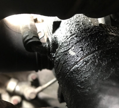

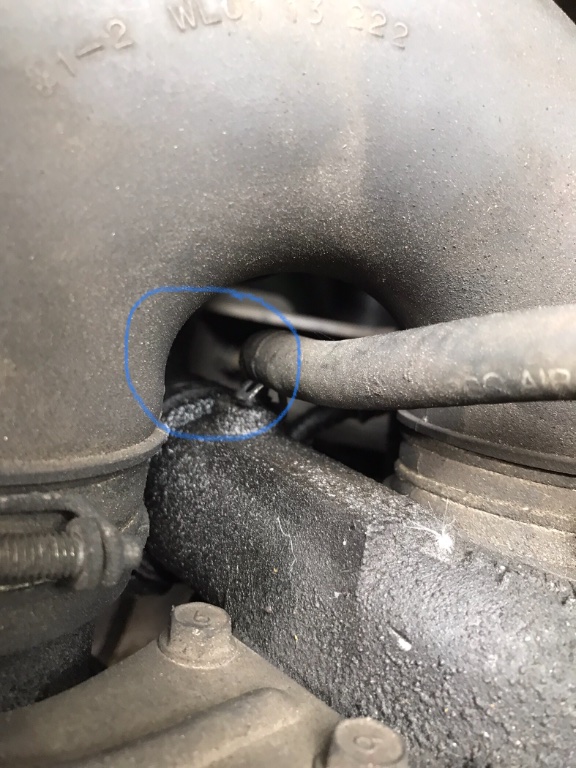

Yep, she is going back next week. In the meantime, I had a look at the Turbo - looks like there is a bit of a leak where the bottom connects to whatever the big rubber hose is. Not enough to drip, but definitely oily! Maybe that is the issue.
I have also just checked our other Bongo (which has no acceleration issues, has the same engine etc) - no leak there! I think I may have found the issue!
Checked https://lushprojects.com/bongoparts/pag ... l).html#27 if I read correctly, the leak is at part 14293 / 14290 ? Does that sound about right?
