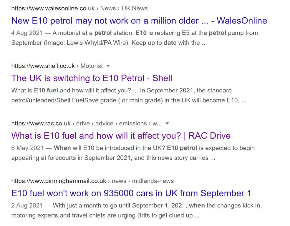

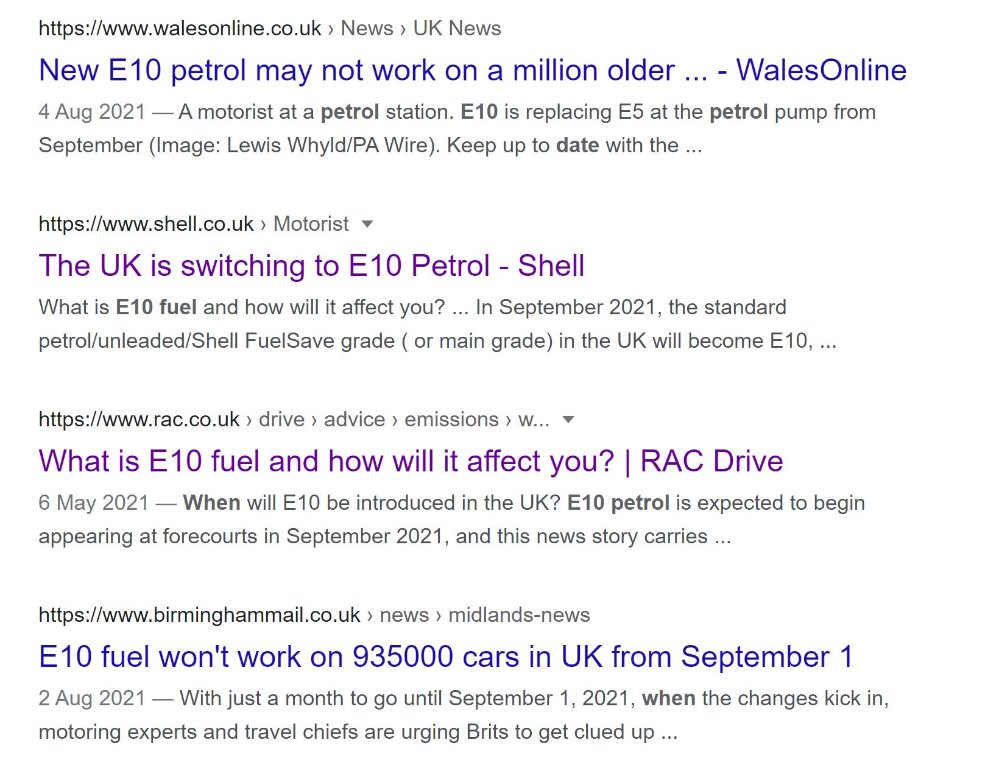

Lots of authoritative sites say its not available until September 2021 ? Sites like RAC, AA my calendar says its still august ?
