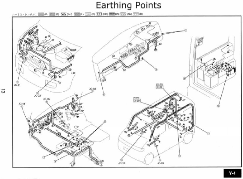

Watched a video earlier about earth problems which reminded me to ask about a couple of problems my Mother has with her Bongo (2.5TD Auto).
If you indicate right, the speedometer stops working.
I presume this is an earth fault, so I was wondering bar the battery terminals where we should look to fix the problem. She did have it in at a local garage for the last MOT/Service and they also tried to find out why it was happening but were unable to find the fault and recommended taking it to an auto-electrician.

There are several earthing points around the vehicle, start with the one by the drivers left foot behind the small panel on the central console; check the individual connectors and the bolt to chassis.

Take off the front grill then you may see a group of Earth's down low near the drivers side headlight, these are really in the weather zone and usually corrode badly, strip and clean may sort your indicator prob.
