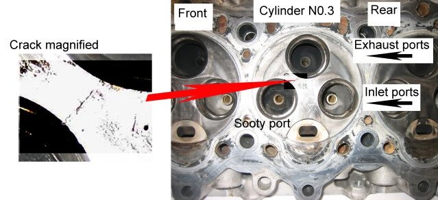

Not sure how you checked the head for cracks ? The cracks when they occur are inside the cylinder head itself;
Well, I mean a visual check on the head itself underneath the drivers side seat. It didn't look like it was dun goofed is all I'm saying, but thanks for that tip!
