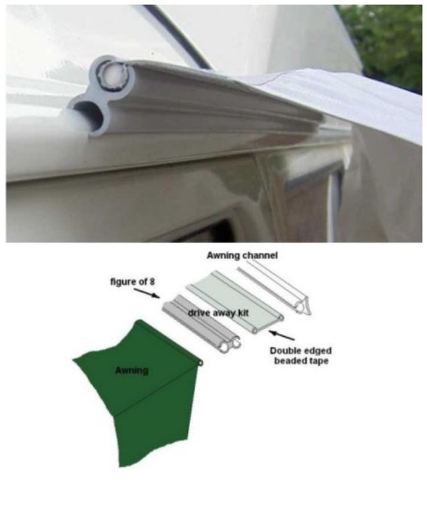

Post by g8dhe » Sun Jun 13, 2021 8:50 am
I seem to recall someone commenting while ago that a magnetic rail was fine until it got windy, then it was a danger as it blew off!
I think most people use a Fig-8 clipped onto the gutter rail and then connect onto that either directly or using the connecting strip to make it easily removable and leave the fig-8 attached to the van.

Post by Shebnpep » Sun Jun 13, 2021 9:26 am
Geoff, thanks for the feed back.
I do have some lengths of 6mm and 8mm figure of 8's so will give it a go.
Much appreciated.
