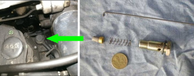

Have you considered the fuel filter and the Banjo filter, below ?

Yes, replaced the fuel filter but not the banjo filter as our model doesn't have one (not all have them ).
