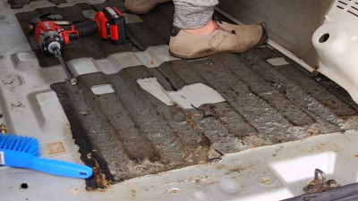

My partner and I recently bought a '97 Bongo. We pulled up the carpet and came across what we believe is the sound deadening pads fixed to the floor.
Does anyone know what material these are made out of, or more specifically if they contain asbestos? Japan was still manufacturing cars with asbestos so a little bit concerned since we starting removing it. I'm in Australia so hoping if it was that it would have been picked up during import.

Owners would be interested in a photo of the material in place, so it's clear to everyone.

I have received the lab results back.
The sample consisted of bituminous material. No asbestos detected. No respirable fibres detected. Organic fibre detected.
The material in question is in picture attached.
I do recommend for peace of mind to get any suspect materials tested, definitely pays off.

A reassuring result - thanks for the photo.
