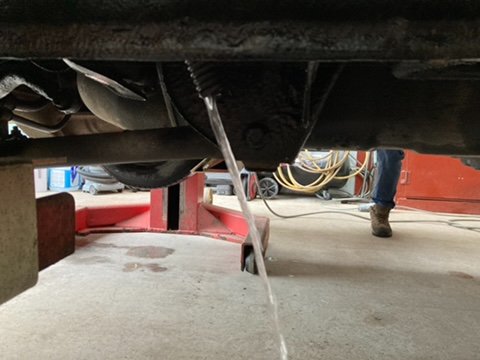

By way of an update, we had the Bongo up on a lift and managed to fix the issue!
As you had suggested, the waste pipe had come loose and managed to work its way up into the sill.
A bit of 'fishing' with some surgery pliers (!) and we managed to pull it back into place and fix it there.
Thank you for your suggestions!

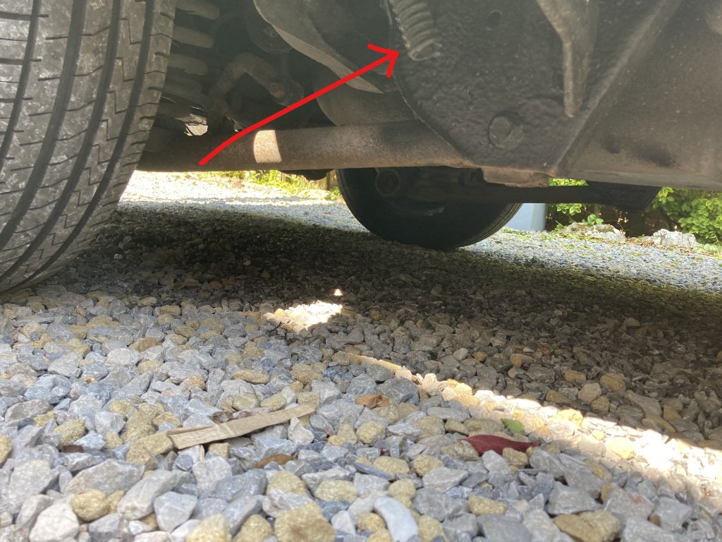

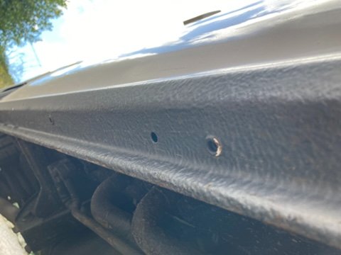

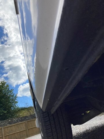

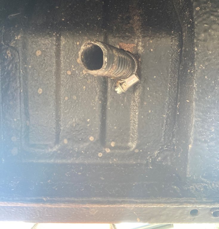

The waste pipe that had disappeared up into the body work was situated just in front of the driver's side rear wheel.
I'll attach some photos, but it is a little difficult to discern.
If you can get underneath your Bongo and shine a torch in any holes that look like they would accommodate the waste pipe (roughly 3/4 inch in my case) then hopefully you can find it hiding!
Hope that helps!
Hope that helps!

Re: Waste Water from the Sill
ohhh nice one, than you very much for teh photos! Found it now..mine looks slightly different but have confirmed where it is
