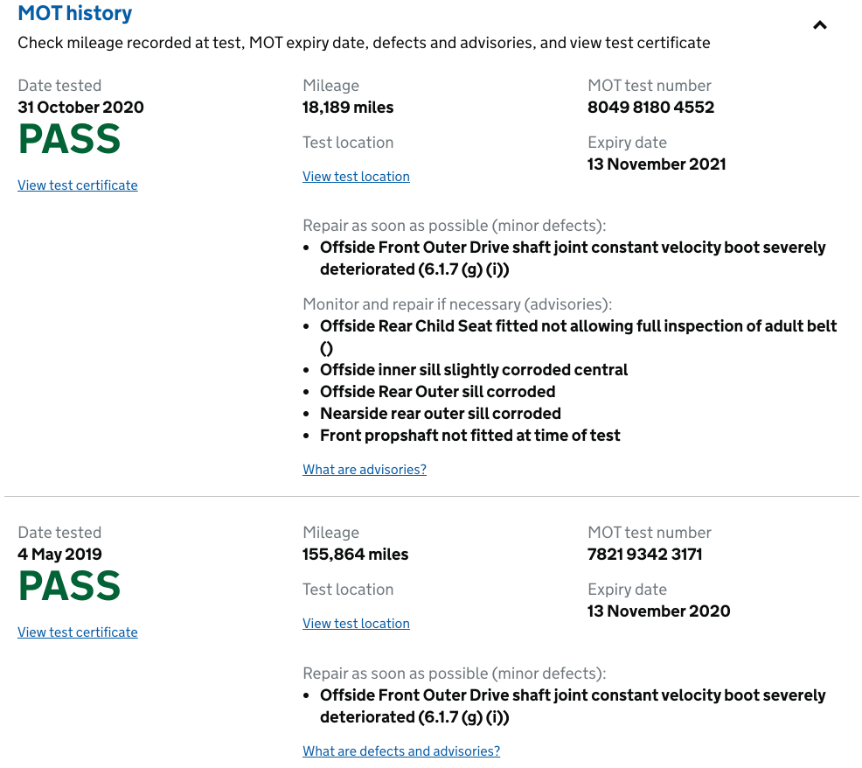

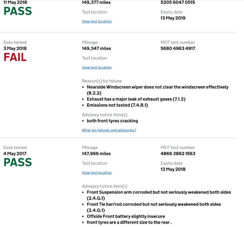

The one we are looking at is a 1996 with 110,000 miles on the clock. 4WD Automatic Diesel. We are waiting to get a lot more detail but as advised I checked the MOT History which has thrown up the following. I am guessing the mileage at the top for the latest MOT is a typo and is actually KMs not miles
My fundamental question / seek to learn is - are the minor defects , advisories big warning lights to let this one go?
I am going to ask the owner what they have done to rectify and show me evidence of repairs etc - but would really appreciate any advice

My main concern would be the removed front prop shaft, I'm guessing it's been done for a reason and may be hiding a serious transmission fault. Plus you won't have four wheel drive.
The rust doesn't sound too serious, but welding can cost £££.
I would go ahead with your plan to rent one for a trip and see how you get on with it - they are 'cosy' for a family of 4, and youngsters generally insist on getting bigger.

Hi, For me Minor defects suggest that they are things that are deteriorating but not yet critical, so I need to have them looked at, at some convenient time, but often they can reappear year after year on the MoT. For instance I have had "Front Coil spring corroded (5.3.1 (b) (i))" appear for 2-3 years now each time I ask my garage they look at it and say "yes some rust but nothing critical or that unusual to be honest" so I keep leaving it. If your not certain or not in a position yourself to verify, why not get the AA/RAC to make an assessment.
Hope that helps.
Just before you read my comment any further Funtimedave, bear in mind I don't currently have a Bongo but am actively looking and might even be close to getting one. I've read an awful lot on here!
I've looked into the removal of the front prop shaft and, it seems, people do that in an effort to improve their fuel economy slightly. Whether or not it ACTUALLY does improve fuel economy is another question. From my research, problems can appear if you were to remove the rear prop shaft and leave the van as a front-wheel-drive. That can damage the rear differentials I think. All this being said, I'd rather keep it as a 4WD because that's how it was designed.
Interesting/non-interesting side note - you fail the CVRT (Ireland's commercial MOT, applies to campers too) if you have a missing prop shaft. If the vehicle originally had 2 prop shafts then it's gotta have them in there for the test.
