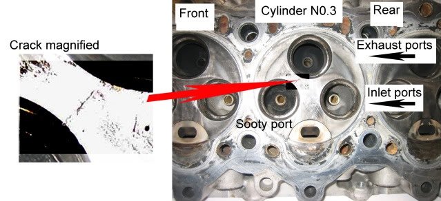

I got round to taking her in for a look over at the local bongo specialist, and it's come up with a cylinder head failure. I had a long chat with the mechanic who explained how they came to this conclusion; using a coloured dye in the coolant system which changes colour based on the presence of exhaust gases. So, there's some breach between combustion chamber and coolant channel, though we cant say to what degree.

Sounds a good approach, its very rare to see the coolant getting into the oil, the usual problem is crack in the head between the exhaust ports that allows exhaust into the coolant
