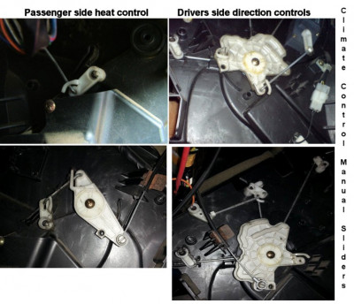

It's possible the rod that operates the heater flap, in the driver's footwell, has become detached, or the heater matrix may be full of crud.

Have you checked the actuation of the heat flap in the passenger foot well ?
Have you checked the temperature of the coolant pipes feeding the front heating matrix ?
