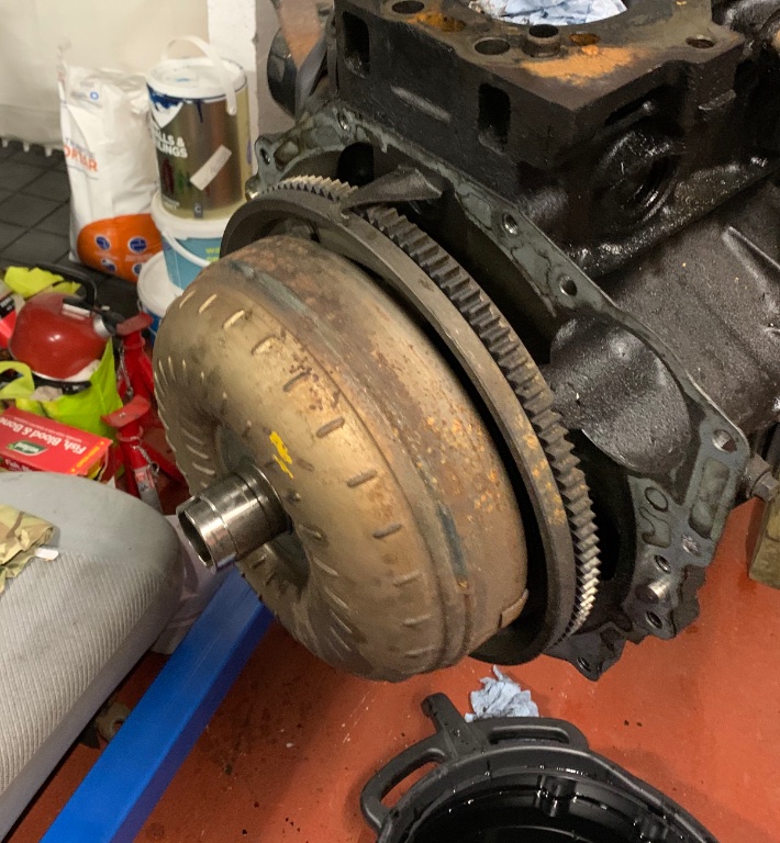

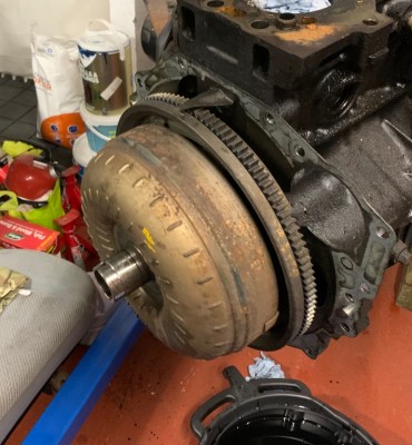

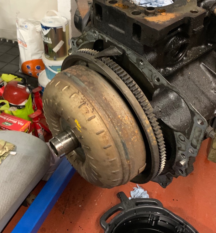

Post by Batesy86 » Thu Dec 31, 2020 3:41 pm
Quick update. Engine & gearbox are out...took some head scratching to be able to lift the van high enough as i didn’t have enough wood to chock under wheels etc but I got there.
I’m stripping the engine down and am stuck on the fluid flywheel/viscous coupling (see pic, if it works!) has anyone got any pointers on how to remove this?
It looks like the mounting bolts should be undone from where the starter motor was mounted but either I’m being to simple or I need a special socket as I can’t get any of mine in there?

Post by willow2u » Thu Dec 31, 2020 8:24 pm
Generally you leave torque converter attached in gearbox bell housing there’s 3 or 4 bolts holding it on which you undo from engine side through an access hole covered by a plate I think
