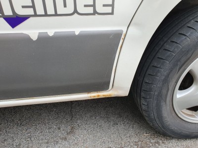

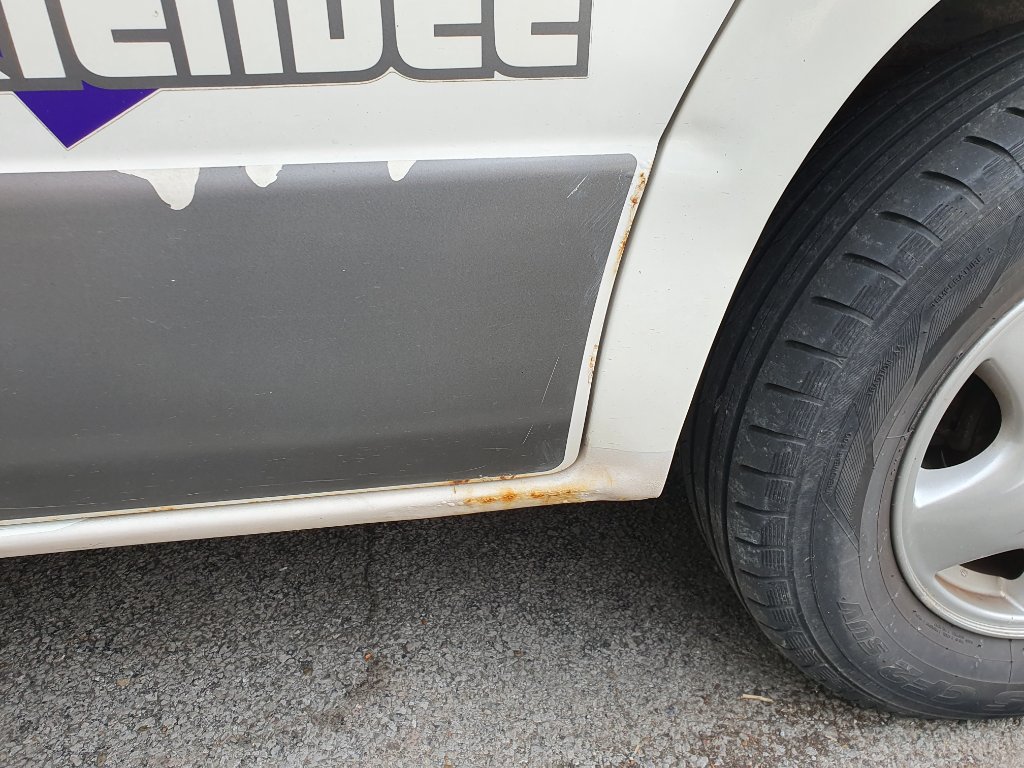

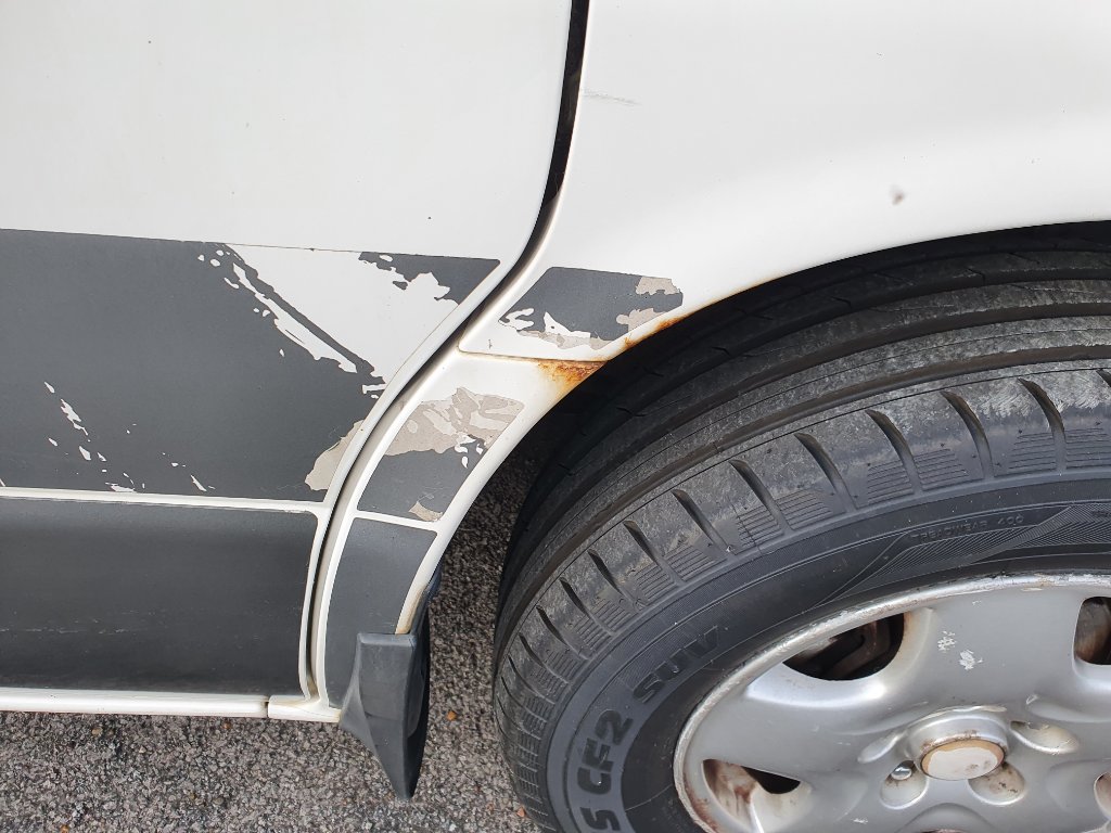

I have some surface rust on the bodywork e.g. around the rims. My paintowrk is white. I will try and post a photo from my phone.
What would you recommend? POR15 (which from looking on Ebay is tough to find in the uk especially in white) or Fertan?
