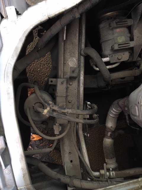

I'm planning on fitting a Diesel heater into my bongo, just wondering if anyone has any tips for fitting into a 2L petrol? Hoping to put the heater under the passenger seat, and thinking of squeezing a tiny diesel tank under the bonnet. Anyone done similar? Haven't found a suitable tank yet, but looks like 2.5L should give me 20hrs of heat, which seems plenty
I've seen the Ebersapcher factsheets (which are great btw), but things look a little different under my passenger seat. I've got some stuff on the nearside chassis rail, not quite sure what it is, thinking maybe a fuel filter?

The cannister is part of the EGR system for venting gases, I think most people move all those bits in-board of the support, then you can attach the heater to the outside area.

Agreed about the flammable liquids, I won't be putting it anywhere near any fuel lines :) That's really why I'm asking what's there. May have to relocate some stuff, or perhaps that location's not viable on the petrols? The exhaust manifold is on that side of the engine, so there are already hot parts around. Was thinking to mount heater on top of the rail with the ports on the engine side, and shift the existing bits along a bit

I’ve just finished install in my v6 under passenger seat. Had to move the EGR tank you highlighted plus ignition coil and some wiring which sits in the same area on the v6. Tank is a 2.5l plastic sat between battery and aircon, just above air intake under bonnet
I’ll get you a couple of pictures tomorrow but as you have way less stuff in 2 L it should just be a case of moving the tank to the bottom of you picture. Only thing I haven’t sussed is exhaust routing - when the heater was fitting my previous diesel exhaust just finished behind slide door but I’ve fitted under vehicle water tank on my v6 which is mostly in the way so going to try and get it to offside instead as that’s better anyway

The EGR tank moved - I’ve seen other installs where this wasn’t necessary and everything was just squeezed in but because I wanted to route outlet to center console this was the best way for me
