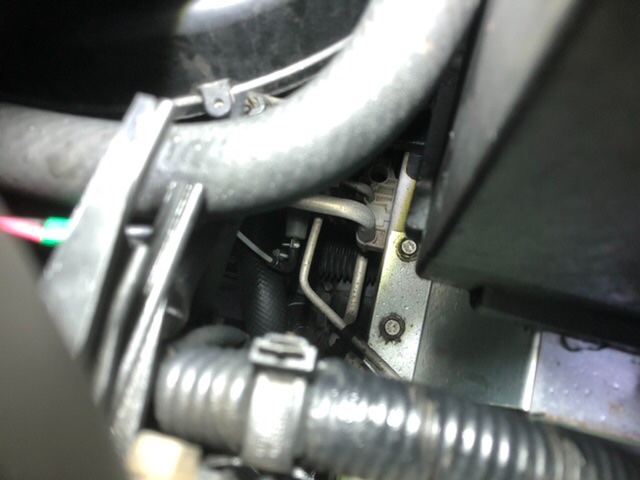

I've seen the Ebersapcher factsheets (which are great btw), but things look a little different under my passenger seat. I've got some stuff on the nearside chassis rail, not quite sure what it is, thinking maybe a fuel filter?

The cannister is part of the EGR system for venting gases, I think most people move all those bits in-board of the support, then you can attach the heater to the outside area.

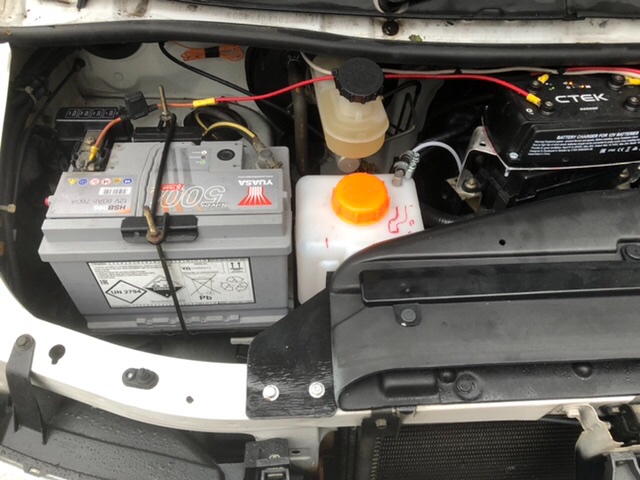

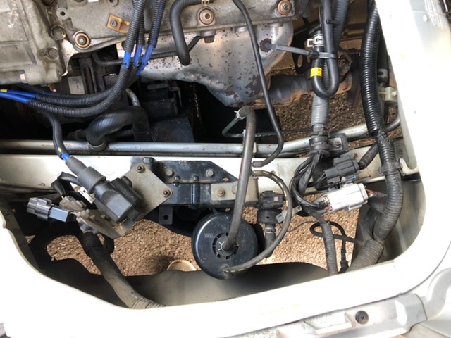

I’ve just finished install in my v6 under passenger seat. Had to move the EGR tank you highlighted plus ignition coil and some wiring which sits in the same area on the v6. Tank is a 2.5l plastic sat between battery and aircon, just above air intake under bonnet
I’ll get you a couple of pictures tomorrow but as you have way less stuff in 2 L it should just be a case of moving the tank to the bottom of you picture. Only thing I haven’t sussed is exhaust routing - when the heater was fitting my previous diesel exhaust just finished behind slide door but I’ve fitted under vehicle water tank on my v6 which is mostly in the way so going to try and get it to offside instead as that’s better anyway

Fuel pump on water pipe bracket (not the best picture)
Fuel tank
Under seat before

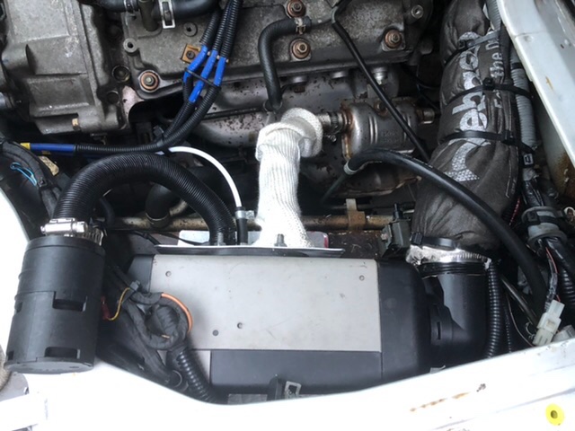

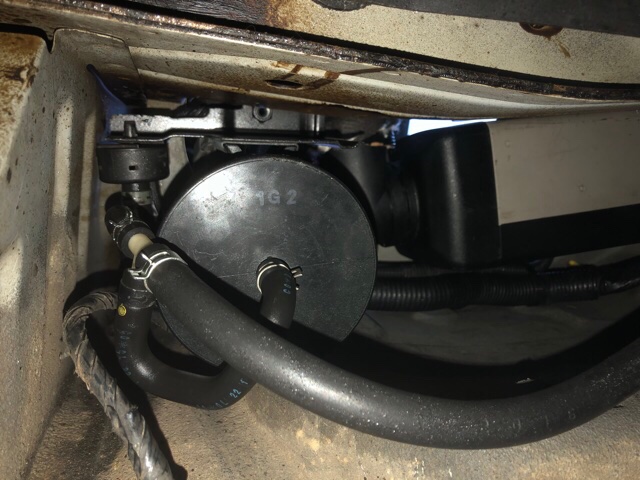

Post by cwilliams255 » Sun Nov 08, 2020 6:58 pm
The EGR tank moved - I’ve seen other installs where this wasn’t necessary and everything was just squeezed in but because I wanted to route outlet to center console this was the best way for me
Finished setup (pending longer air intake hose, old one wasn’t long enough)
