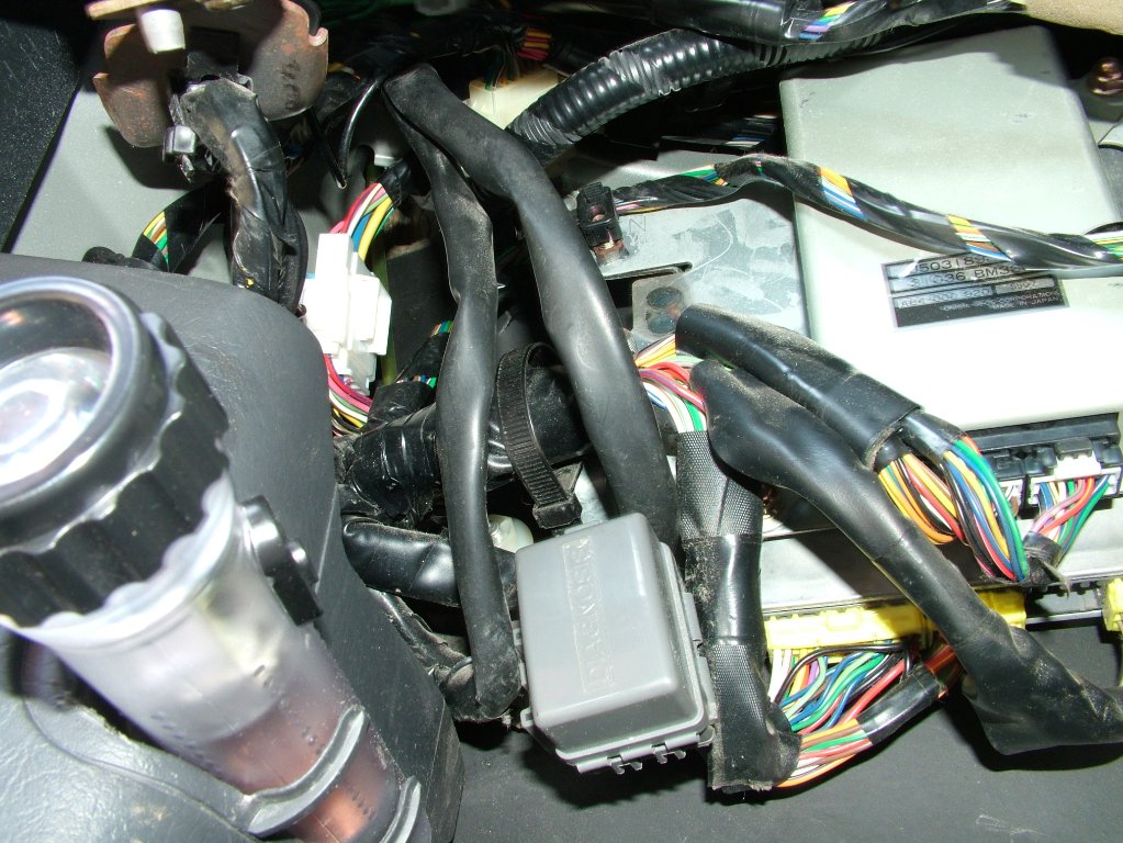

That's the ABS light reporting a fault, most often a faulty sensor but you need to read the diagnostics port out for the error code to know exactly and which sensor if that is the problem. See here if its an early vehicle http://www.philmcfadden.co.uk/MazdaDiagnosticBox.htm

Its down in the passenger footwell on the "A" pillar!
Lift the cover and note the way it is mounted upside down compared the instructions on the link I gave.
