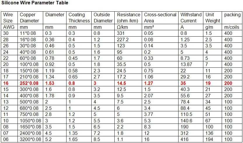

It's all going to depend on what amperage you plan on pulling on your inverter.
I tend to use silicone wire which is usually good quality. chart below for what gauge wire you need for what current it will take.
