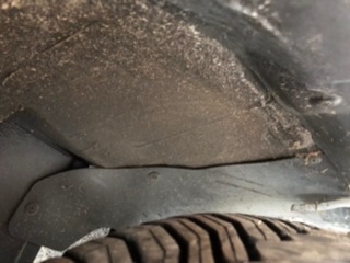

There's plenty on here about the rear arches but has anyone had to sort the front inner arches? mines are a bit 'soft', just wondering if repair panels are available or is it a case of just fabricating something?
Also is there meant to be a plastic liner on the rearmost part of the inner arch (above where the mudflap would sit)?, Neither side on mines has ever had one & this is the bit that's needing sorted, just wondering if a missing liner has caused this?

Think OP may mean the flitch panels or inner wing panels.
OP can you upload an image of the bit your talking about?
cwilliams255
Posts: 124
Location: Sheffield
Re: Front inner arches
Post by cwilliams255 » Wed Sep 02, 2020 5:41 pm
Mine had holes here
You could put your finger through to the passenger footwell carpet, sold it but had a plate welded over it as far as I know

cwilliams255 wrote: Wed Sep 02, 2020 5:41 pm Mine had holes here
Yes, thats the bits, my fingers will go through them if i push on them.
In 20+ years in the motor repair trade i have heard them called flitch panel’s or even heard the term flitch panels before. I would call that part the inner arch or inner wing panel.
Every day is a school day I suppose.
So can it be bought as a pre made panel or is it making something up out of sheet metal?

As far as I am aware there are no pre-formed panels available but they are easy to shape up. Needs good strip out in that area to make life easier.
The section at the bottom of the A pillar around mudflap area is a box if you have problems there then opening up that section may reveal more corrosion in there. Esay to check if you have a cheap USB endescope Ebay.
