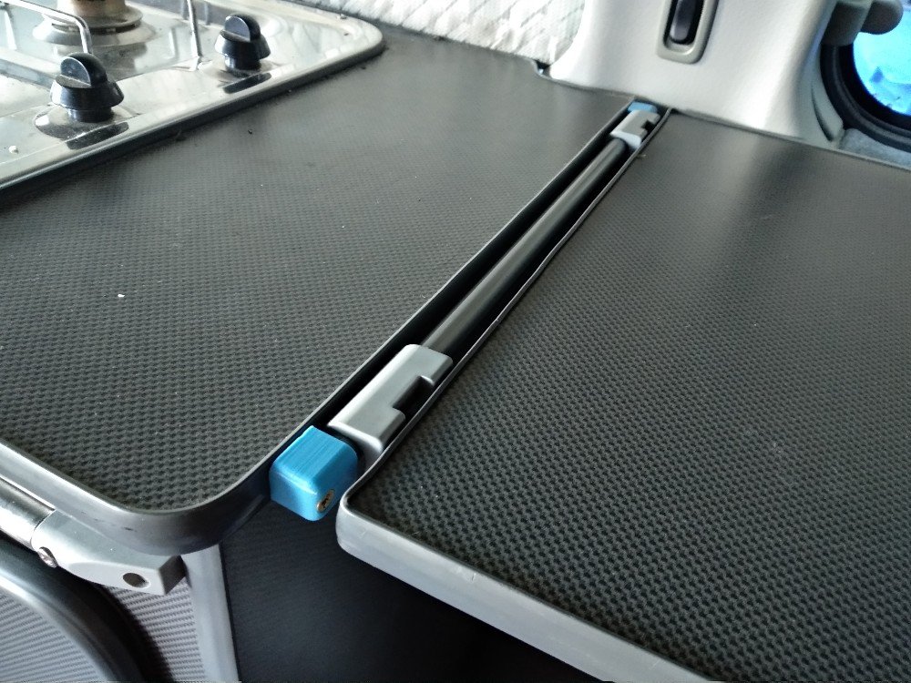

The first was the table. We use the table but have always said how it would be useful to be able to put the table on the end of the kitchen unit (mid conversion) to extend the workspace for cooking. This would put it over the rear chair. I looked into an extra rail kit but they were £37 🤔. So I designed and printed a couple of brackets and found a scrap tube of metal and voila created a rail kit for about 10p. I also made a mount to connect a short tube to, to work as a shorter leg.

Here is a photo of the table rail kit...
The blue bits are the printed parts.

Neat. 8)
