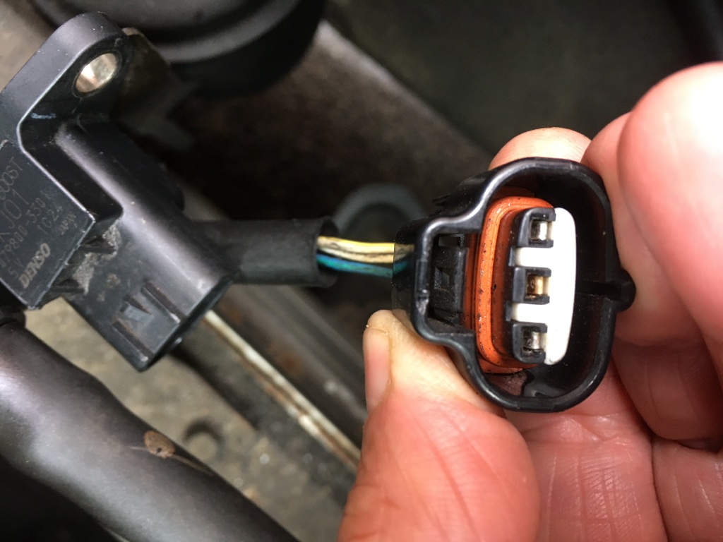

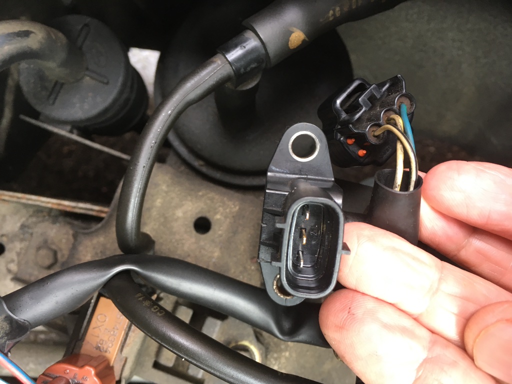

Hi All,
Still trying to solve my turbo problem,
I have a friend who is a electrician who seems to think that the problem is caused by the black sensor boost solenoid under the passenger seat, he has asked me to try to confirm what this solenoids function is,
Is it a potentiometer
Is it a triack device, or a electronic gate.
What readings should there be across the two outer pins,
What is the function of the centre pin.
Thank you all

Might help if you could show us a picture of what your looking at ?

Hi g8dhe,
Thank you for your reply, any information on this sensor would be much appreciated.

Not that familiar with the diesel but I suspect its the EGR position sensor your holding;
Red/Black is the wiper.

It doesn't look like a solenoid with three connections, the colours match the circuit diagram on the connector, as well as the connector style.
I don't have a diesel engine manual, perhaps someone with one can confirm the part.

Any part numbers on the body of the part?
Can you put up another image or two of the oart and one with it in situ.

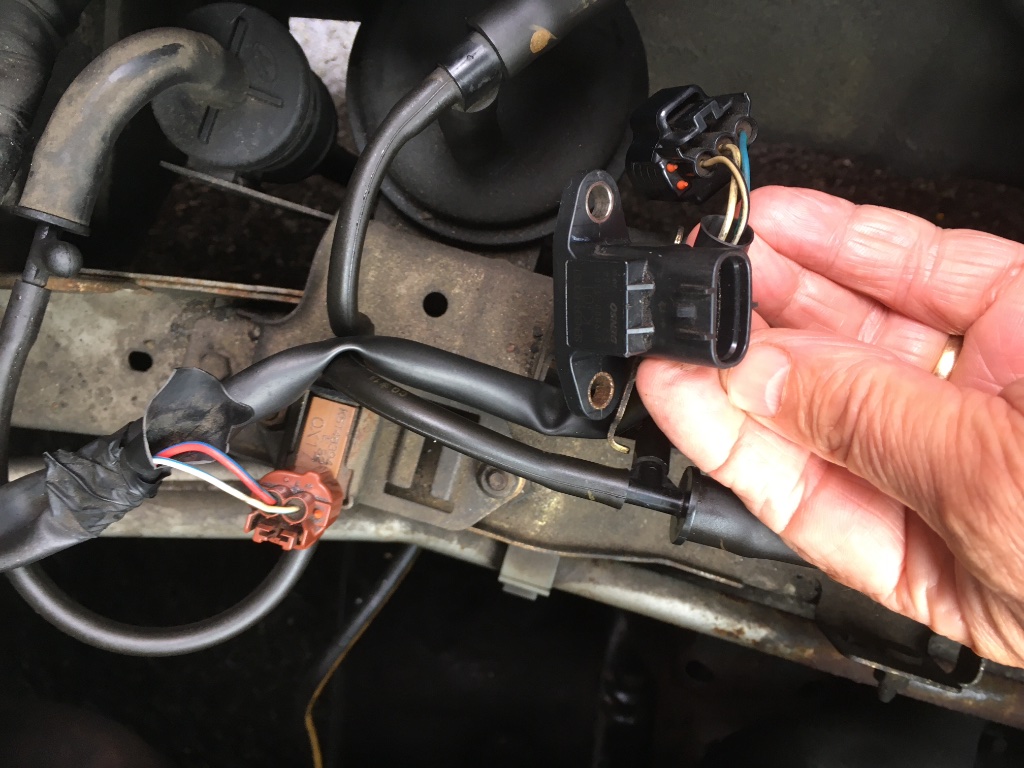

Hi Bongolia,
I have all the part numbers off the body of the solenoid, I’ve contacted Ian who informs me that this part is no longer available,
But there is a replacement part available from Mazda RF4F18211 I have not followed this up as of today.
To be honest I was a bit puzzled with one of the posts on this link, mentioning that it looked like a EGR position sensor.
Originally had P codes 0400 and 1228, but took both EGR valves off and cleaned them. The codes disappeared, but the glow plug started flashing 1227 and this is where I’m at the moment.
The turbo actuating arm moves forward on starting from cold but then within about 2 seconds it closes.
Apart from this problem the van runs fine I use occasionally with no other issues.
Sorry but can’t get out to take a photo it’s storm conditions here today.
There are two solenoids under the passenger seat a brown one and the black one both are bolted to the chassis rail.
Any information regarding this is appreciated, it’s driving me nuts.
Thank you
Clayton

Right its the Boost Pressure Sensor mounted on the intercooler piping - 18-211D original part#:KJ0118211A
http://www.lushprojects.com/bongopartsm ... mgno=.html
its on versions after 1999 it seems.
It measures the air pressure in the intercooler.

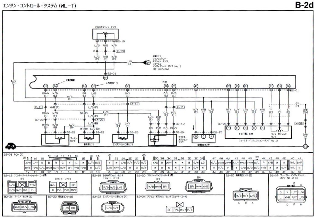

This is from the 1999-9 version of the wiring diagrams B2-25 connector

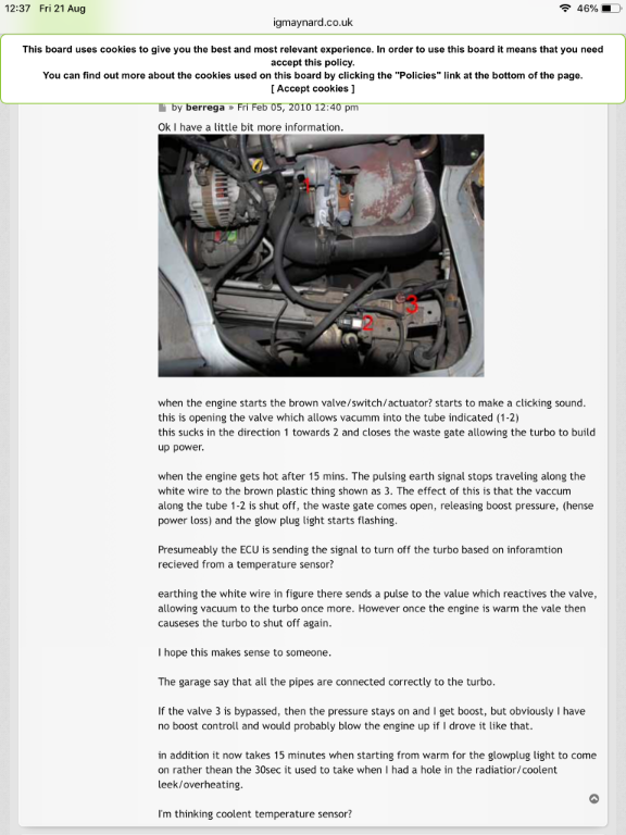

download/file.php?mode=view&id=248
Hi Bob,
It’s certainly the right part number, but mine is bolted the passenger side chassis along with a brown solenoid and in some way
influences the opening and closing of the turbo.
The on the passenger side must measure the vacuum then?
I’ve uploaded a photo from another post which explains it and shows the lay out.
Thanks Bob
