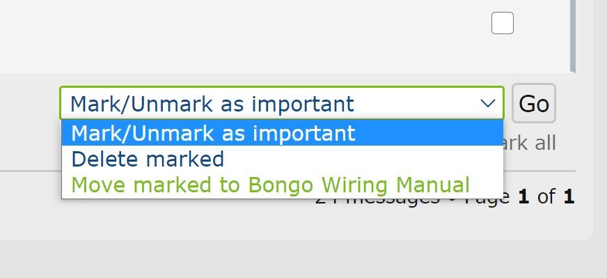

Posts: 10972
Re: ATF capacity
Post by g8dhe » Sat Aug 08, 2020 8:24 pm
In the lower right corner open the drop down menu and you can choose the action;
after selecting the messages to be actioned.
Posts: 15488
Re: ATF capacity
Post by Bob » Sat Aug 08, 2020 8:42 pm
Yes, thanks Geoff
Selected messages to delete, clicked 'Detete selected', comes up 'The submited form was invalid'.
Never had that before. :?
