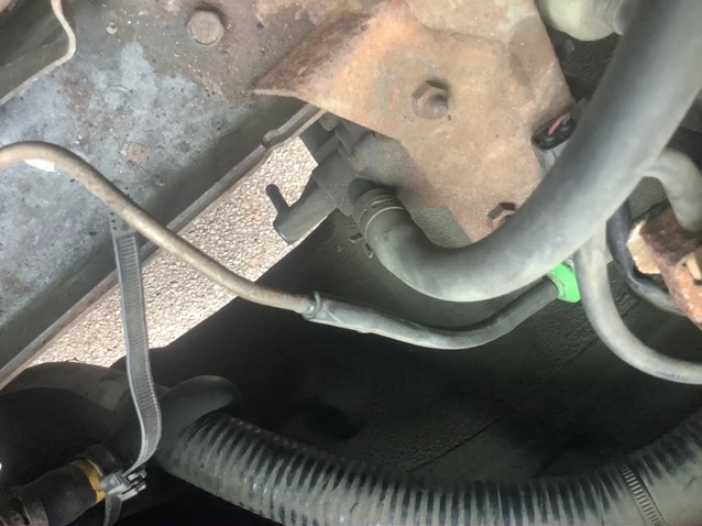

I have had some long term issues with my 02 2.5 diesel giving the flashing glow plug codes for turbo and wastegate issues.
I took it to a garage who reconditioned the turbo which was rusted solid (they think someone kept topping up coolant with water in the past...) that worked for a while but the issue is back and I can’t get back to the garage for a while. They also had to rebuild the vac system as someone had changed it to hide some of the issues the van had, like the solenoids all being rusted and broken.

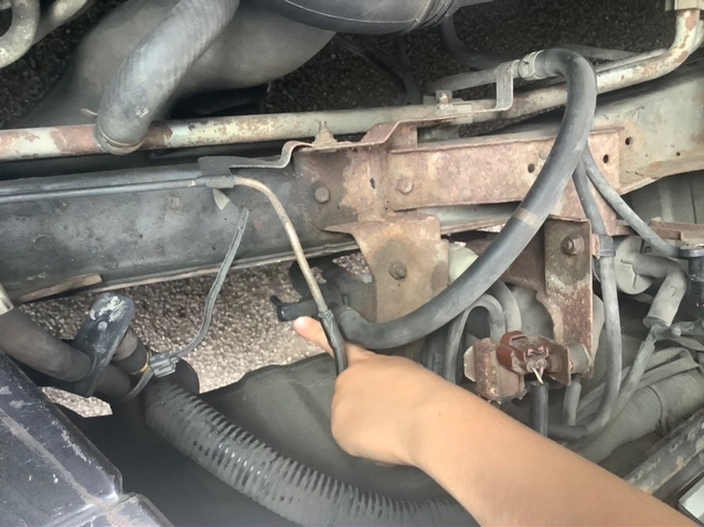

Anyway whilst giving the actuator arm a wiggle to free the turbo I noticed this part of the vacuum system is not connected. This photo is taken looking under the passenger seat. The other connections all seem to match lush projects. My understanding from lush is that this missing connection should be to a 3 way connector between the metal line from the front and the one way valve.
Am I right? What does it do/difference will it make?

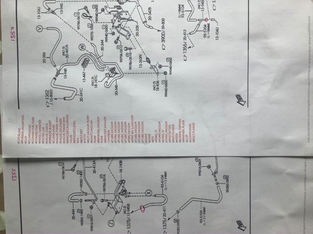

Have you found the mechanical diagrams and in particular the vacuum piping diagram ?
http://www.lushprojects.com/bongopartsm ... 1of02.html

Post by Bongofamily » Thu Aug 06, 2020 9:15 am
Hi, thanks for quick reply the part in question is at the bottom of drawing 1355. There is a U shaped pipe coming off the connection labelled 1357-20-411. On the other drawing that seems to match up to a three way connector, but an end cap is shown too?

Post by Northern Bongolow » Thu Aug 06, 2020 7:34 pm
It's for the winter pack, depending on whether it's fitted or not as standard, or been removed.

Post by Bongofamily » Thu Aug 06, 2020 10:06 pm
Thanks, mine does have some elements of the winter pack but not all. For instance the second battery is now leisure battery but I do have the snakes in the engine button. If leaving this disconnected only means that will never work I think I’ll leave it alone with two small wannabe bongo drivers...
