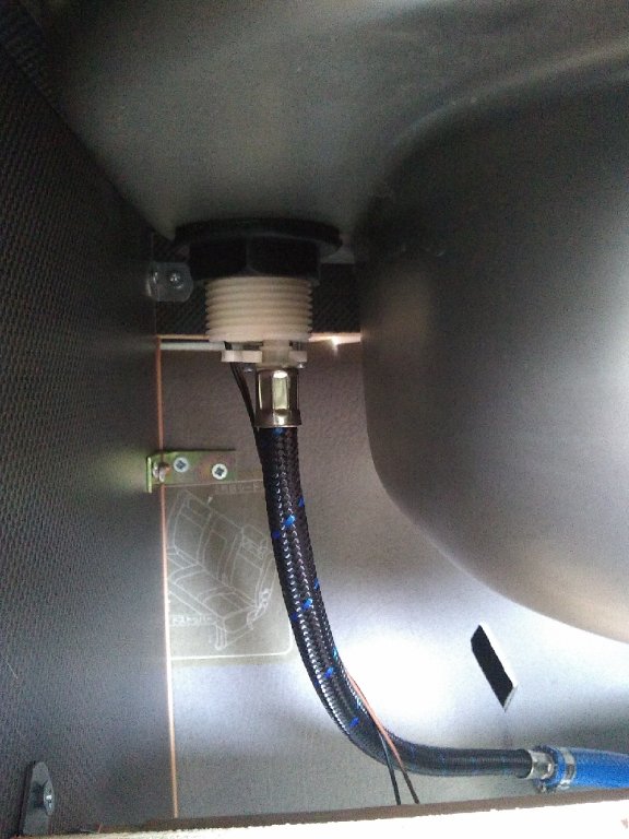

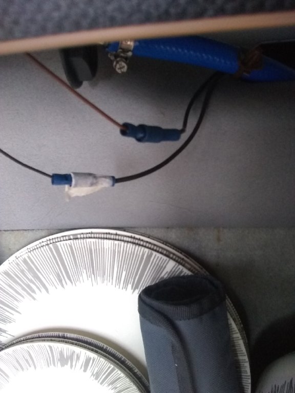

Ok, here are a few pictures as planned, with apologies for focus quality... Best viewed from bottom to top. On the middle one I haven't screwed the backing plate fully back into place as I've only replaced it to take the pictures.
From the bullet connectors the wires go to the zigg unit. Some of the leakage ran down the outside of the water pipe and also contacted the connectors.
Any ideas welcome!
The bullet connectors

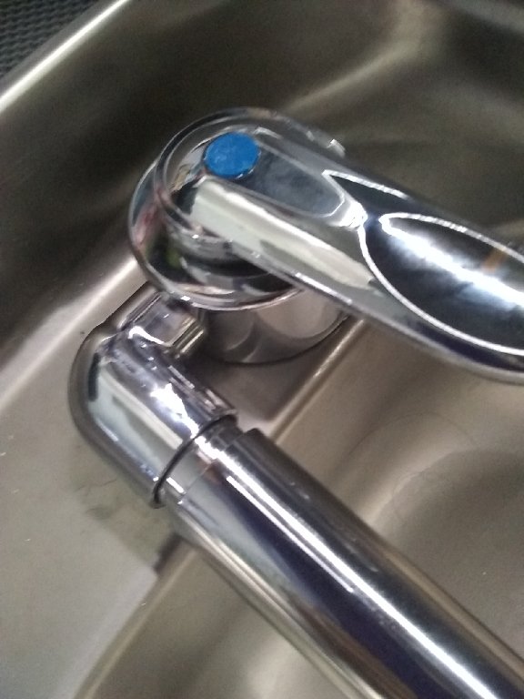

The tap as fitted - water leaked from the outlet, and under the sink

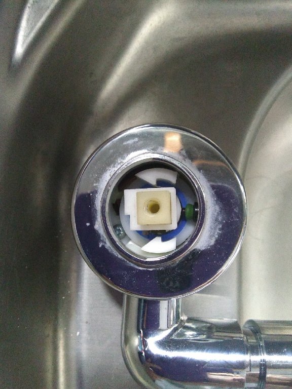

... and the tap. This is as far as I got with disassembly as it looks a bit difficult to put back together, and the wires seem to connect ok with e switch.
