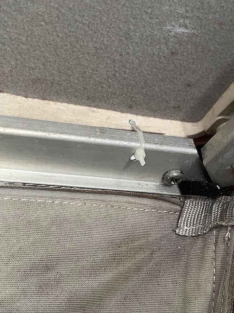

Excuse my rather late entry to this discussion... I recently had this problem and solved it using thin plastic cable ties instead of screws/glue. Much cleaner and quicker. Most things in life can be solved with plastic cable ties. :D

How did you use a cable tie ? The holes are blind so you can't have passed a tie thru. Or was it just used as packing to wedge it in place?

…I remember now-I ignored the broken fittings and got out the drill…
